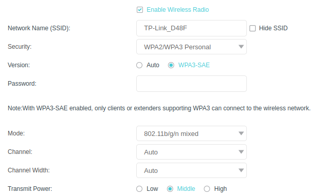

Currently I am able to connect to open/wpa/wpa2 wifi network but not to WPA3-SAE using Zephyr RTOS and CC3351.
Here is the configuration of the Access Point (TP-Link):
I have ran a "wpa_cli status" from my laptop to get more parameters:

On the MCU side, I request the connection by calling Wlan_Connect with the security type of WLAN_SEC_TYPE_WPA3.
I've got no error on this call and I receive no event from the CC3351 (connecting, connected nor error).
From the CC3351 logs (attached to this ticket) I've found the following logs:
2,,2025-09-30 14:21:41.436,0,0,sme.c:873,1,**UNKNOWN_FUNC for lr 0x000996b1(),SME: Trying to authenticate with b0:19:21:ef:d4:8f (SSID='TP-Link_D48F' freq=2462 MHz),8100400000b196090000100000b01921efd48f0c54502d4c696e6b5f443438469e09
1,,2025-09-30 14:21:41.437,0,0,drv_ti_sta_specific.c:158,1,**UNKNOWN_FUNC for lr 0x000a394f(),"ti_driver_authenticate: SAE auth commit, auth_data_len = 102",80004f390a0066
2,,2025-09-30 14:21:41.520,0,0,drv_ti_sta_specific.c:916,1,**UNKNOWN_FUNC for lr 0x000c0d81(),Sending auth request packet to b0:19:21:ef:d4:8f (auth type AUTH_ALG_TYPE_SAE # tries 1),8100000000810d0c00010000001162303a31393a32313a65663a64343a38660301
2,,2025-09-30 14:21:41.521,0,0,sme.c:1364,1,**UNKNOWN_FUNC for lr 0x000a01b7(),CTRL-EVENT-AUTH-REJECT b0:19:21:ef:d4:8f auth_type=3 auth_transaction=1 status_code=1,8100000000b7010a0000000000b01921efd48f030101
I see an error in CC3351 logs but I don't receive this error through the event handler on host side (I don't receive any event in that case such a WLAN_EVENT_ERROR).
Do you have any idea what is the meaning of this error on CC3351 ? And why I don't receive those errors on MCU side ?
