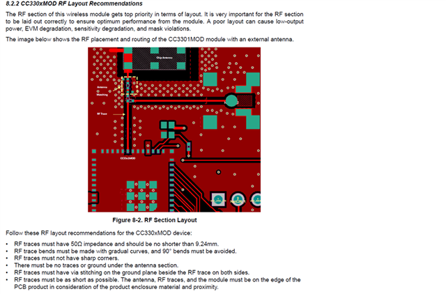

I have a further question about the RF Layout Recommendations:
Please can you confirm whether the RF trace should be no shorter than 9.24 mm?
This sounds strange to me and contradicts the recommendation that RF traces should be as short as possible.
  • Hi Jan.
    That is correct. The minimum length needs to be 9.24mm. The guidance " RF traces should be as short as possible." is for customer designs that cannot meet 9.24mm EXACTLY due to constraints. The guidance is then to make it as short as the design will allow.
    Josh
