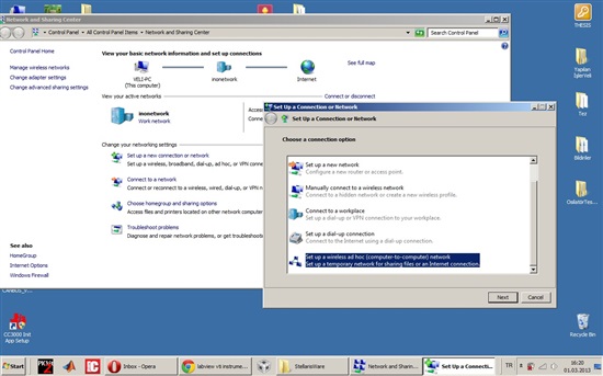

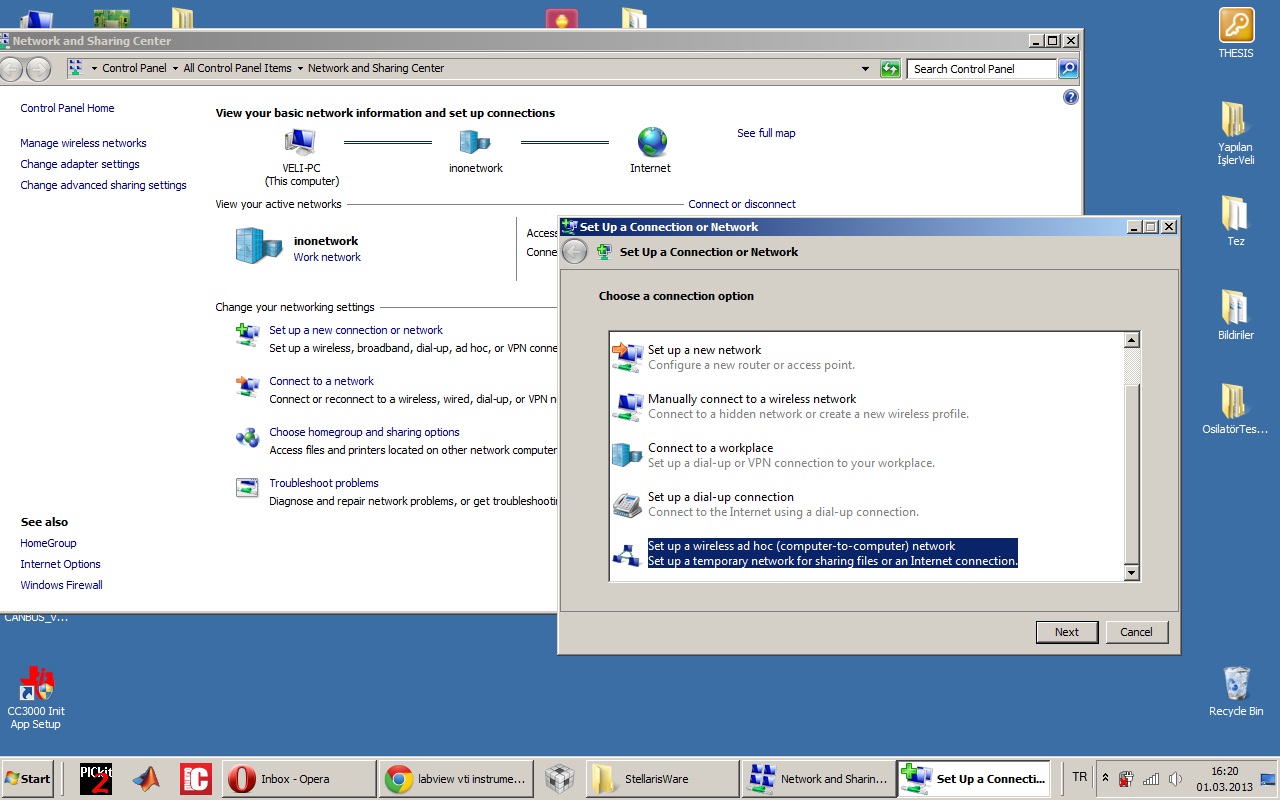

Thats good for Windows 7, but what about Windows 8 (where there is no option to create Ad-hoc network)?
Is there any way to directly connect the CC3000 to a Windows 8 tablet without using a router?
As you explained above I can create the network using Set up a new connection network, over there I can choose Set up a wireless ad hoc (Computer to Computer) network to create a network and I can use this network name and password to establish connection with CC3000 Wi Fi chip.
Please correct me if I am wrong.
Actually I can establish a connection in between PC(win7) and CC3000 using soft access point but the problem with soft access point is that it goes away as soon as I restart the PC.
So I need some way around where I can establish network once in my PC and I can use it all time.
My basic agenda of clearing a doubt is, I dont want to use router in between PC and CC3000, so is there any other soultion other then soft access point that I can use to establish peer to peer connection in between PC and CC3000.
