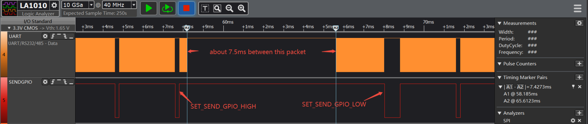

    I observed an abnormal phenomenon while testing continuous serial port transmission. After sending a few packets of data (each packet being 256 bytes during the test), there is an interval of approximately 7.5ms in the middle of one packet. This causes the transmission speed to slow down. I tried both UART2_Mode_BLOCKING and UART2_Mode_CALLBACK in writeMode, and the same phenomenon occurs. The testing method is as follows:

2. Send via the following method: Create a transmission task with each packet of 256 bytes. In this task, send continuously. Configure a GPIO pin to pull high before each transmission and pull low after completion, which facilitates convenient observation of this anomaly.

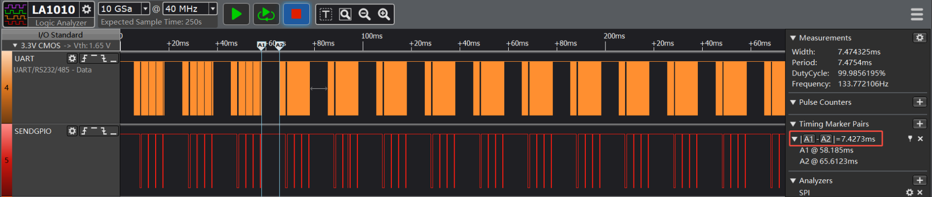

3. The phenomenon captured by the logic analyzer is as follows: after sending a few packets of data, there is an interval of approximately 7.5ms in the middle of one packet transmission, which will result in a slower speed when sending data continuously.

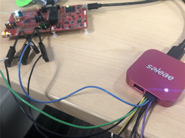

    I wanted to tell you that I did not follow your steps (since you were experimenting there anyway), and ultimately did not recreate your issue.
    I have attached my code and SYSCFG to this response.
    When hooking up the logic analyzer, I never saw a 7.5 ms delay, which you can see since my entire 256 byte transaction took place within the green block:
    I had 4 transactions (1 second delay in between) and none had any delay in the middle of a packet.
    I am open to your feedback.

    I am struggling to reproduce your issue. I enabled flow control in SYSCFG and still did not see your issue; I did not hook anthing up to the flow control pins either. Please see my analyzer trace:
    Each block looked like this which showed 0 indication of a 7.5 ms delay.
    You can see I'm just probing my device which is running a uart2echo example (code I sent you previously). Can you try that setup and then adapt it your application?
