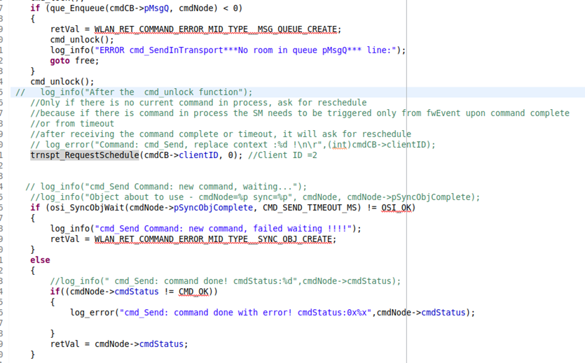

To further validating other SDK API, we tried few “wlan_comd.c” api after confirming the parameters on TI EVAL board.
  ret = cmdWlanStartCallback("");
  ret = cmdGetFwVerCallback("");
   //ret = cmdWlanRoleUpStaCallback("-r \"00\"");
   //ret = cmdScanCallback("-n 2");
    ret = cmdWlanRoleUpApCallback("-s \"Thermostat_AP\" -t WPA/WPA2 -p \"12345678\" -r \"00\"");
we found cmdWlanStartCallback, cmdGetFwVerCallback, cmdWlanRoleUpStaCallback works correctly.
We found cmdWlanRoleUpApCallback and cmdScanCallback fail in “cmd_send” function as below
  • On executing “trnspt_RequestSchedule” we came across “FW is stuck” error
  • On executing osi_SyncObjWait, it fails to take Semaphore and system crash with log in red colour
Our queries:
  1. The way we are testing command is ok?
  2. What might be possible reason for “cmd_send” to fail for cmdWlanRoleUpApCallback and cmdScanCallback and not for other command?
  3. Is there any issue with power supply since we are giving supply using laptop usb port (no c type)
Thanks....

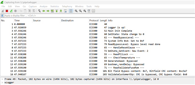

  • Hi All,
    We captured CC3300 Log from our development board having CC3300MOD and TI Eval board having CC3301MOD.
    We found difference in log.
    Please analyze the log and tell us the reason for difference and whether it has any relation for few SDK API commands not working as mentioned above.
    Log files 5 June.zip

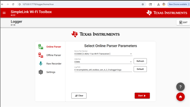

  • Hi All,
    We also captured raw log Wlan_connect in following scenario one at a time.
    //ret = cmdWlanConnectCallback("-s \"GalaxyY\" -t WPA2 -p \"9833276215\"");  - FW STUCK error observed
     ret = cmdWlanConnectCallback("-s \"GalaxyY\" -t OPEN"); - FW stuck error not observed. But not connected to AP.
    2026_06_08_14_45_40_WLANCONNECTOPEN.zip
    2026_06_08_14_55_49_WLANCONNECTWPA2.zip
    Please give us input to our queries related few CAllback commands are not working mainly related to RF operation.
    We are waiting for last 2-3 days.
    Thanks........

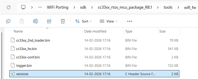

  • Hi Yogesh,
    Can you send me your terminal input/output rather than the FW logs for testing the commands?
    Since some of these commands are working and others are not, I am inclined to think it could be a power related issue. On the AM-243 host, we require a 5V / 3A USB-C connection in order to ensure operation, I am not sure of the STM32F412ZG requirements but I imagine they would be similar.
     What is the CC3301MOD's host? Is it the same STM32F412ZG device or how is this configuration different from just the CC3300MOD?
    I cannot read these files as these are .bin, but this is explained either by wrong command format (AP is not OPEN, so cannot connect), or not enough power to initiate connection, causing FW error.
    If the issue is confirmed to not be power, the fw_downloading_ini_params process should be verified and investigated.

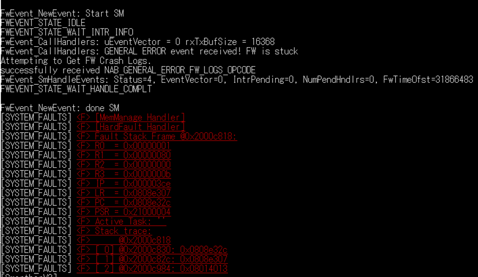

    •      What is "FW Stuck Error"
    Terminal Log 9 June.zip
    Thanks.....
  • Hi Yogesh,
    This error is sent when anything causes the FW to crash. In looking at the code around where that error message is printed, I found something critical: I do not believe that the initialization completed. As per snippet below, there should be a print statement with the status of rom loader, second loader, fw wakeup, and ini params if they have finished initializing by this point. Because we don't see this print statement, I believe this indicates what I mentioned at the end of my last post, that the fw_downloading_ini_params process should be verified and investigated.
    Since it appears like the device is not browning out due to lack of power, I think the ini params are the root cause. Can you share how you determined these were being initialized correctly?
    Josh Prushing

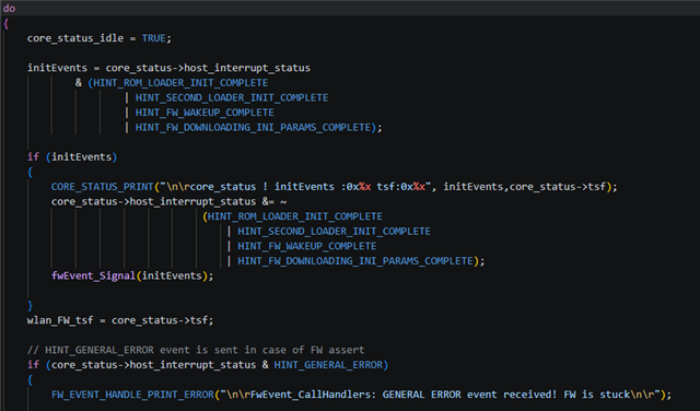

  • Hi
    We just check log "WLAN_START_STA_SCAN.txt" log
    We found all expected events in log.
    core_status ! initEvents 8 And :17035
    core_status ! initEvents 16 And :4993091
    core_status ! initEvents 32 And :6925
    core_status ! initEvents 64 And :54663  (HINT_FW_DOWNLOADING_INI_PARAMS_COMPLETE)
    Did we understand wrong. Please clarify.
  • Hi Yogesh,
    Those logs indicate the device became unresponsive and the watchdog forced a reset, I'm not exactly sure what caused this but at least one of the initialization processes must've failed. I will try to investigate this more in detail over the next few days.
    Josh Prushing

    Yes, we are using "cc33xx_rtos_mcu_package_R8.1"
    We are using attached binaries from package. FW Version showing 1.7.4.329
    Our queries:
    What is use of "Logger.bin". Other binaries we are using currently.
    Currently we are using only 3 binaries other than "Logger.bin". Any other binary required to transfer to CC3300?
    Now we are thinking RAM Bootloader is not getting invoke properly. So Host is sending command to CC3300, but CC3300 is not responding. Is our understanding correct.
    Those 3 are the only other binaries.

    To confirm if this is true, can you take some FW logs? You will need some sort of UART to USB or cable.
    In the toolbox, go to logger, under Online Parser -> Device Part Number select Custom Parser File and under Parser Bin select your logger.bin file. Select your COM port and use the default log path. Can you send the logs for the whole init process?

    • -------------Validation Start -------------
    • -------------Container Validation Success -----------------
    • -------------Invoking WSOC FW -----------------
    • Main Init finished successfully, Firmware version cc3xxx_rev_ ....
    Josh Prushing
  • Hi
    We are using logger tool as below.
    We are using "Online Parser" and started application using "Start" button
    Wireshark window opened.
    Once log captured, we used to copy log from Wireshark and shared with you.
    Not remembering that we have selected "logger.bin".
    Attached "logger.bin" present in our SDK and all other binaries.
    1882.wifi_fw.zip

  • Hi Yogesh,
    Instead of choosing CC3300 in the "Device Part Number", please select "Custom Parser File" as seen below. There will be a new option called "Parser Bin", this is where you upload logger.bin file.
    All other steps are correct.
    Josh Prushing
