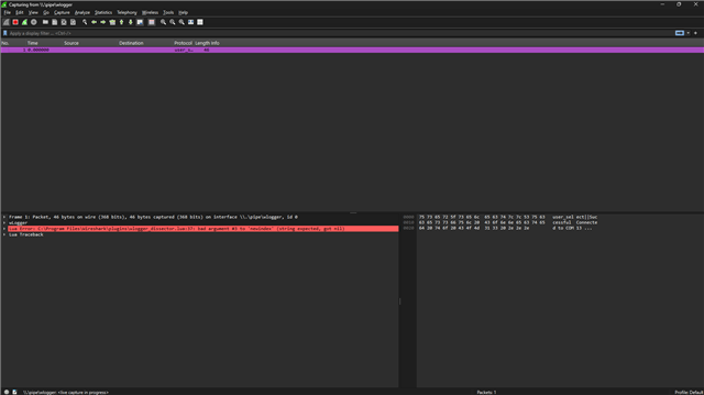

    I also attempted to capture the firmware logs using the Logger tool, but I encountered the following error in Wireshark:
    Lua Error: C:\Program Files\Wireshark\plugins\wlogger_dissector.lua:37: bad argument #3 to 'newindex' (string expected, got nil) [Expert Info (Error/Dissector bug): Lua Error: C:\Program Files\Wireshark\plugins\wlogger_dissector.lua:37: bad argument #3 to 'newindex' (string expected, got nil)] Lua Traceback
    Could you please check whether this is due to a compatibility issue or if there is something incorrect in my Logger/Wireshark setup?

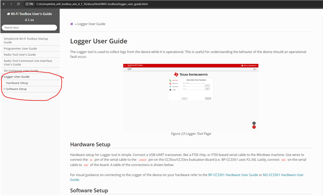

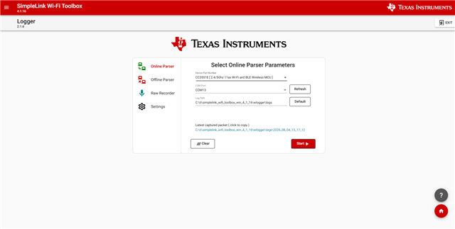

  • Hi Shivam,
    Can you switch to these settings instead?
    Additionally, that SDK version uses SYSCFG 1.26.3. Please switch to that to rule out any issues on that front.
  • Hi BLiu,
    I tried parsing the logs as per the instructions you shared in your previous reply. However, I couldn't find the logger.bin file in the location shown in your screenshot. Instead, I found it at the following path:
    C:\ti\simplelink_wifi_toolbox_win_4_1_16\radio-tool\binaries\CC3551E\logger.bin
    I used this logger.bin file along with the device part number as the custom parser file. However, I am still encountering the same error in Wireshark.
    I have changed my syscfg version to 1.26.3. Could you please let me know if there is anything else I should verify?

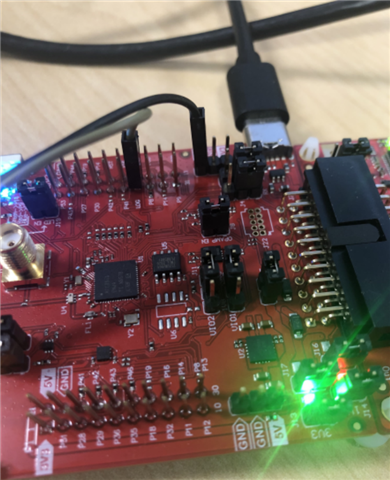

  • Hi Shivam,
    I am getting the same error as you, but it is not preventing me from getting logs:
    Here is my physical setup as well. Do you have FTDI drivers installed? I'm using an FTDI cable for this operation.
