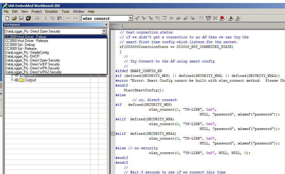

I recently bought the LS Research and FRAM MSP430 Wifi Evaluation module (part number CC3000FRAMEMK). I was able to get the Sensor Demo (with the little Wifi Planets orbiting the host sun) working with very little trouble, but that demo doesn't model my application very well. The Data Logger application, as it is described anyway, is much closer to my target application, but I can't get it to run.
I downloaded the application and was able to flash the Data Logger binary onto the evaluation module, but no matter how the TP-Link AP is configured, the EVM will not connect. The Wiki for the Data Logger indicates that the SSID should be "TP_LINK" but in reading the source code, the default SSID is "TP-LINK." There is no mention of what security should be used, even though the Data Logger app appears to support WEP and WPA/WPA2.
It seems like there should be some way of setting up the AP so that this demo works immediately. What do I have to do to get the Data Logger to associate with my access point?

    1) You are correct. It should be TP-LINK (the wiki has a typo)
    2)  The Default TP-LINK AP has no security. In the DataLogger application, you need to select from the drop down box the security you want to use:
    Then, change "password" to the AP password (this is not needed for the no security part. Each one of those projects.
    In general, the wlan_connect function is what you want. Below I put the doxygen comments for it.

    If I understand your reply correctly, all I should have to do in order to see the Data Logger run are the following:
    • Download the latest version of the Data Logger app (from here: http://www.ti.com/litv/zip/swrc237a)
    • Restore the factory defaults to the TP-Link router and then truncate its SSID to simply "TP-LINK"
    • Flash the Data Logger binary to the EVM
    • Turn on the AP, wait 30 seconds, and power-cycle the EVM
    • Once the EVM connects to the AP (by illuminating LED1), start the PC Data Logger GUI
    If that sounds correct to you, something else is wrong. I have been following those steps and have not been able to get the EVM to associate with the AP. The EVM fails to connect and then slowly blinks LED3 every time. I have to admit that I'm at a loss as to what to do here.

    The Data Logger doesn't use the same LED structure as the Sensor application. The data logger seems like it's working.
    1) Go to the TP-LINK web server @ 192.168.1.1 with user and pass both "admin. Go to the DHCP Client list and look whether your device is connected. There should be 2 devices there, one the computer you're using and the other the CC3000 (the LSR module has the MAC on the top and you can compare with the MAC given by the AP.
    Make sure to use "TP-LINK" and not "TP-Link".
    2) What do you see in the GUI? Do you see changes in the temperature? It should be sent by the device to the GUI.
    Gustavo
  • I agree that the Data Logger doesn't use the same LED structure as the sensor, but I disagree that the data logger seems like it is working. From the CC3000 Data Logger Wiki (http://processors.wiki.ti.com/index.php/CC3000_Data_Logger_Quick_Start):
    "The embedded application will power up the CC3000 and try to connect to the correct AP (TP_LINK). While the CC3000 is trying to connect to TP_LINK LED2 will blink rapidly for a maximum of 3 seconds. If the TP_LINK AP is found then LED1 will light up. If not, then the application will go into First Time Config mode and will blink LED3 at about 1 Hz. If this happens you may need to start over at Step 4."
    The EVM does exactly what is described for failing to connect to the AP. LED2 blinks rapidly for several seconds and then LED3 blinks at 1Hz. LED1 is never lit.
    When I load the PC GUI, I see no evidence of any activity. The graphs are never populated with any data. But I have no reason (yet) to believe there is anything at all wrong with the PC GUI.
  • Just for completeness, I also checked the DHCP Client List in the router, and it confirms that only one device (the PC) is connected.

    You're correct. It is not associated, but did you check the DHCP Client list table in the AP?
    1) Is the SSID "TP-LINK" all uppercase?
    2) What is the security of the AP?
    3) What configuration did you select for the project? Did you choose the appropriate one and changed both places where "password" appears to your passphrase?
    Gustavo
  • Gustavo,
    1) Yes. The factory default is something like "TP-LINK_BA8233" where the last bit is just some part of the router's serial number. All I did was delete everything after "TP-LINK."
    2) Default. No security.
    3) I did not choose any configuration for the project. It seems to me that rebuilding the binary should not be necessary, especially when it is included in the package. I flashed the included binary directly to the device using MSP430Flasher.exe. This is the same mechanism for flashing the Sensor Data binary to the EVM, and that worked perfectly fine. In case you're wondering, this is what the command line to flash the device looks like:
    MSP430Flasher.exe -n MSP430FR5739 -w "../../CC3000_FRAM_Applications\Binary\cc3000_fram_datalogger_1_0_0.txt" -z [VCC] -v -g

    I am not sure what configuration the binary is using. Please use IAR to configure the project and download it.

  • My evaluation period for the MSP430 version of IAR has expired. I have been assuming that the configuration described in the Wiki would match the included binary (no security, SSID "TP_LINK") but since there's already at least one instance of inaccuracy, I suppose it could all be up in the air. I'm not a software developer and am not scheduled to do any software development on this platform; would it be possible for you to provide me with a rebuilt binary? I am just trying to characterize power consumption for this device.
  • CJ,
    I tested the file attached with a TP-LINK AP. LED1 is solid indicating a connection.

  • Gustavo,
    I think I'm closer. The EVM powers on and blinks LED2 rapidly for several seconds. Perhaps 10 seconds. At some point while LED2 blinks, LED1 comes on. There is a period of several seconds occasionally when LED2 is blinking and LED1 is illuminated. The PC GUI receives a little bit of information from the EVM, and then all the LEDs turn off and LED2 begins blinking again. This process repeats indefinitely and a full cycle takes about 20 seconds. In that 20 seconds, there appear to be a couple seconds of successful Wifi connectivity:
    I have tried power-cycling things in all kinds of orders, for example:
    • Turn off AP and EVM, wait 10 seconds
    • Turn on AP and wait for PC to associate
    • Start PC GUI
    • Turn on EVM
  • Another note which shouldn't be of any consequence, but might be anyway: the PC running the GUI has a wired, not wireless, connection to the AP.
  • CJ,
    The behavior of the application is correct. the Data Logger logs the information of the temperature and periodically sends it to the PC GUI.
    In the GUI, put the mouse on the arrows. There should be a chart with the temperature information.
    Gustavo
  • Oh yes, so it is. I didn't realize that the EVM fully dissociated from the AP between every temp sample. But I see now that it is working fine. Temp data is logged, and the accelerometer streaming works fine.
    You should see if you can have the binary included with the download package replaced with the one you sent me. Might save some people some trouble down the line. Thanks!
  • Hi CJ,
    depending how long it takes to associate to the AP you may find it difficult to characterize the power consumption as it may not spend any time in sleep due to the short report cycle period.  Furthermore, this is just a demo application and so power consumption could be reduced further.
    Mathieu
  • Mathieu,
    I'm sure there are a lot of variables, but my situation is very nearly best-case here. The AP is 10 feet away, it is using no encryption, only has two connected devices (only one of which is wireless), and there are only a handful of other SSIDs broadcasting in this environment. Increasing range and adding other devices or encyrption would only make the situation worse. You can see some details of my findings in a discussion I started here:
    http://e2e.ti.com/support/low_power_rf/f/851/t/172533.aspx
