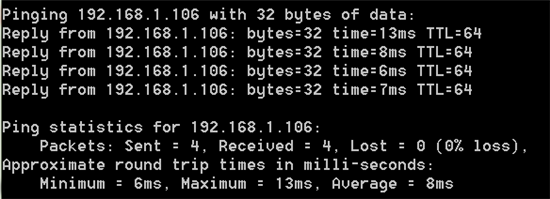

Below is the packet I sent to configure my CC3000 to have 192.168.10.2 as IP and 192.198.1.1 as Default Gateway.
08c0a80a02c0a80101
After sending in the packet I did get a response on the HyperTerminal which said Done. However upon pinging the IP address using command prompt, I did not get a response from the CC3000. Am I doing anything incorrectly? Please advise.

    It is possible that the octets need to be inverted. The Gateway IP octets should be first, then the IP we want to use. Try
    08c0a80101c0a8016a
    Let me know how it goes.
    Gustavo
  • Gustavo,
    Sorry about that. I forgot to connect the PC to the AP before sending the ping commands. But it works! I configured 192.168.1.106 and 192.168.1.107 and checked to see if it responds only on powering on the MSP430 board, and it does. I've inserted screenshots of the ping command for anyone's reference. Thanks again!
