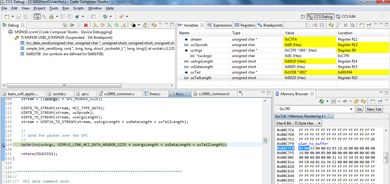

    I did some more debugging on the SEND DATA and what I observed is my previous command "03" which is a socket is not populating ulSocket variable with correct value. Value of ulSocket (and so value of "sd") is 0 when the application is doing sendto.
    Any reason why above could be happening? I will do some more debugging on identifying whey socket() api is returning 0 but any quick pointer here would be helpful.

    I followed the steps mentioned above but still I can not send the packet out from CC3000. Below is the screenshot showing the call stack execution on send command and wlan_tx_buffer before it performs SpiWrite to CC3000. Is there anything missing in the wlan_tx_buffer as this is the buffer which seems to be used to send data/command info to CC3000 to do all operations.
    My CC3000 ip address is 192.168.1.105.
    My PC ip address: 192.168.1.106
    Here is the output of the command which you sent, which shows socket 137 for my PC IP address.

    As per my previous log, i sent the memory capture for the wlan_tx_buffer before it is sent via SPI to CC3000. I think that is the command which goes to CC3000 finally to do any actions. Is that correct? If answer is yes, then do you see any thing wrong in that command?
