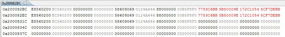

    b) Please put debug point in the patch programmer right after reading the content of the radio modules. cRMParamsFromEeprom array should be filled. I would like to understand if this array is zero after reading the content.

    value in cRMdefaultParams is as above starting from address '0x200082BC'. It is not same as default values or not even zero. Please let me know if you think it is still valid. by the way what are the radio parameteres and what is the structure of this array. From developper point of view, where these parameters will come into the picture? Also the return of the "nvmem_read(NVMEM_RM_FILEID, 8, 8*index, pRMParams); " is 0x03.

    Looking into the code, 0x3 means invalid data. This means that the programmed radio module parameters are invalid. In case that happens, the patch programmer should write the default ones. This means that on your next attempt to run the patch programmer, or just reading the radio parameters, you should receive correct values.

    0x3 means invalid data. This means that the programmed radio module parameters are invalid. Please run the patch programmer as is. It will write the default parameters since the existing data is invalid. Then put a break point at the read. You should not receive any error.
