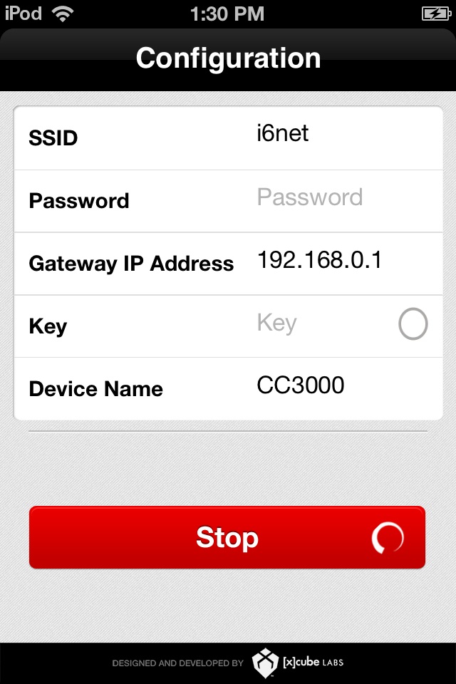

Router Detail :
I am using IPOD app while performing smart config, here is the snap shot of smartconfig app configuration
