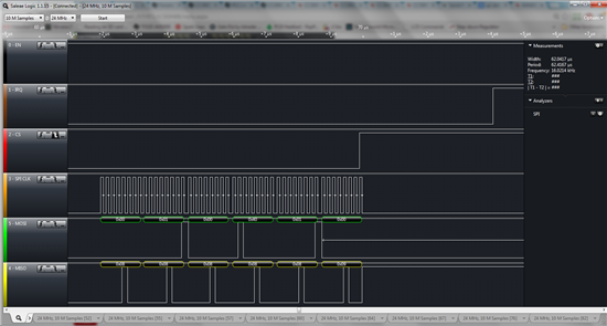

    Below are the captured logic waveform.

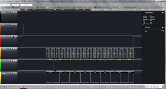

    1. overall waveform of first write and first read

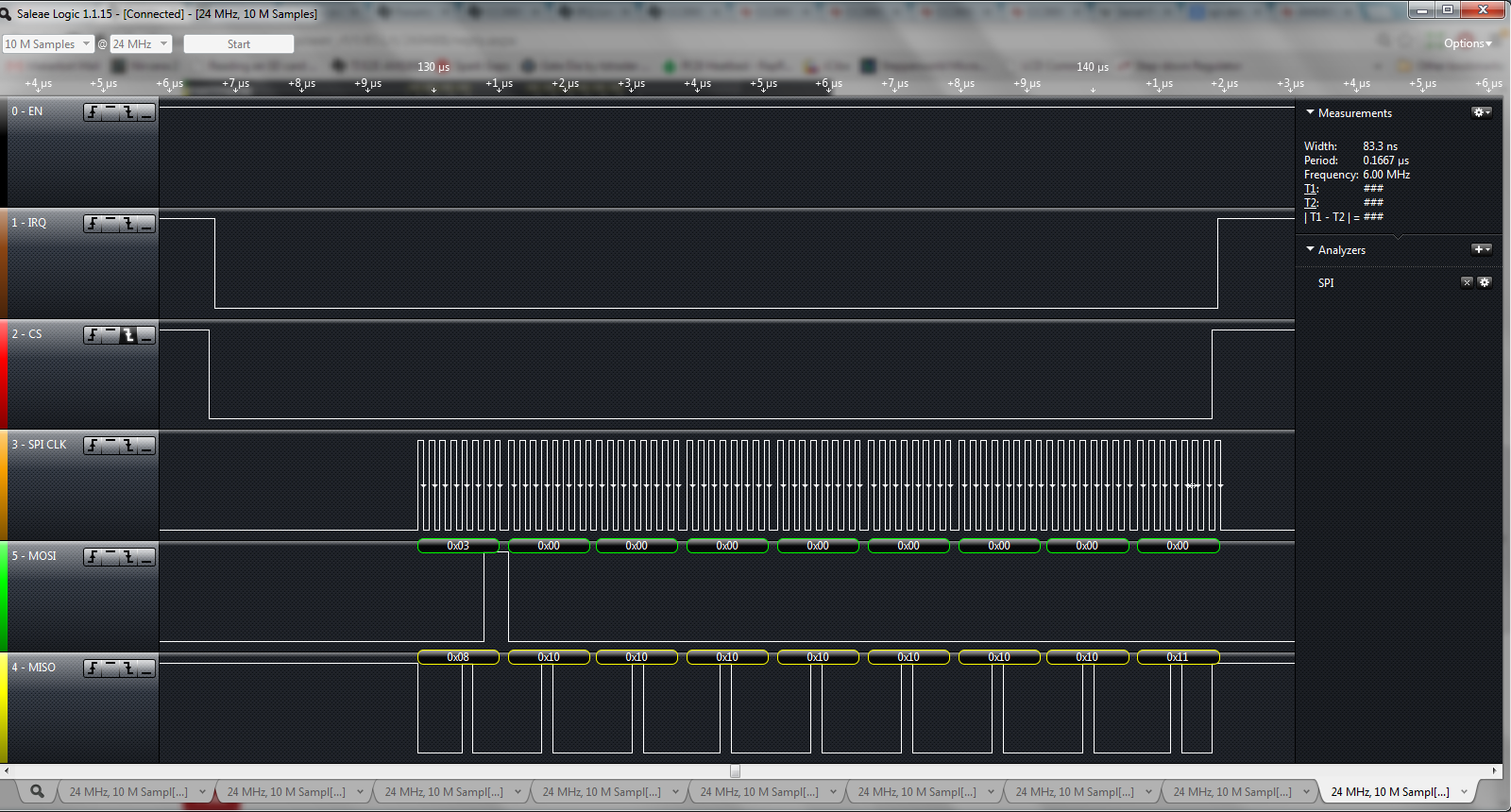

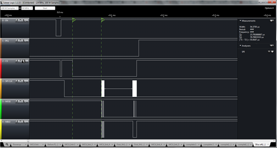

    2. First 4 bytes of write

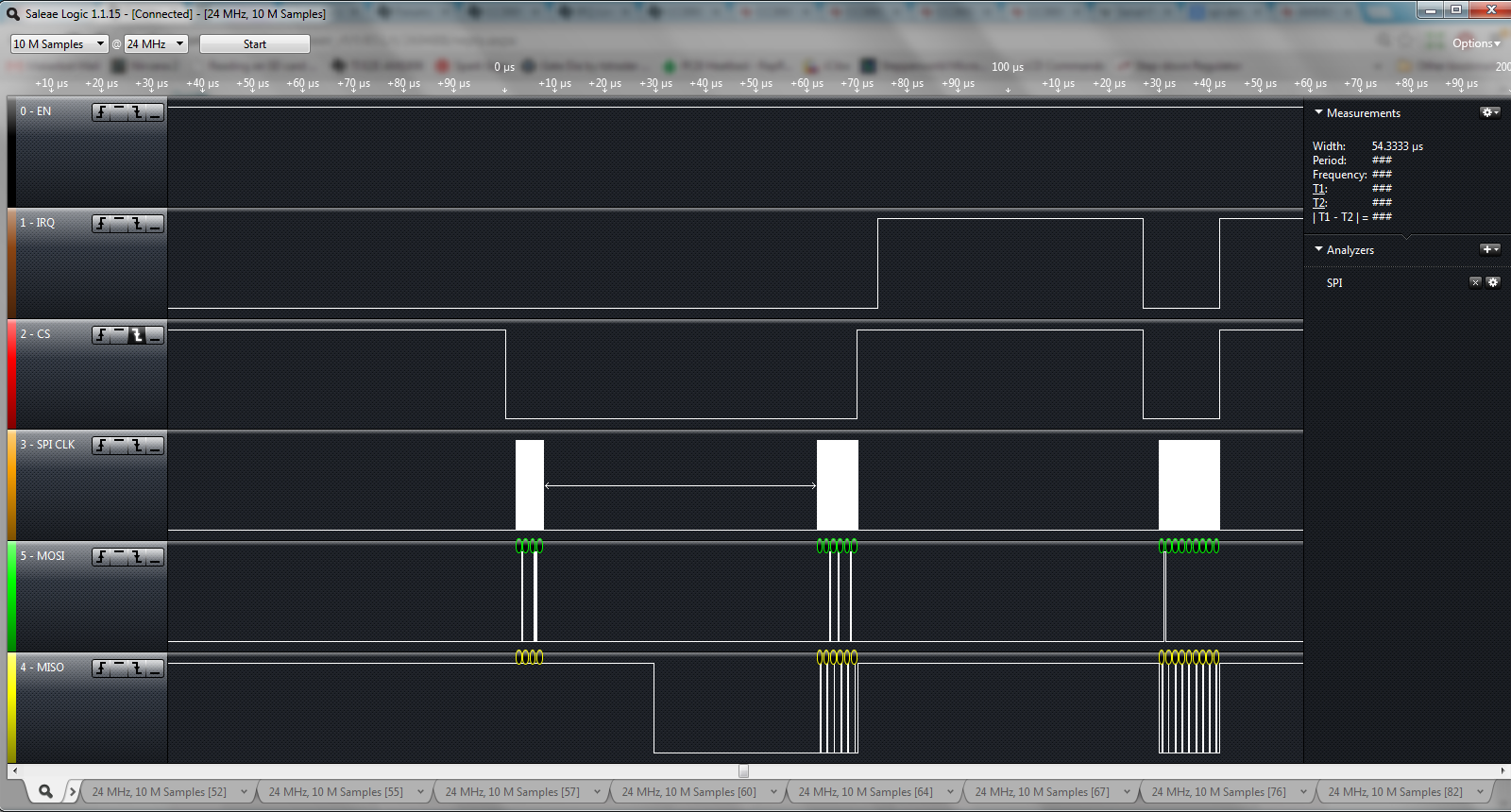

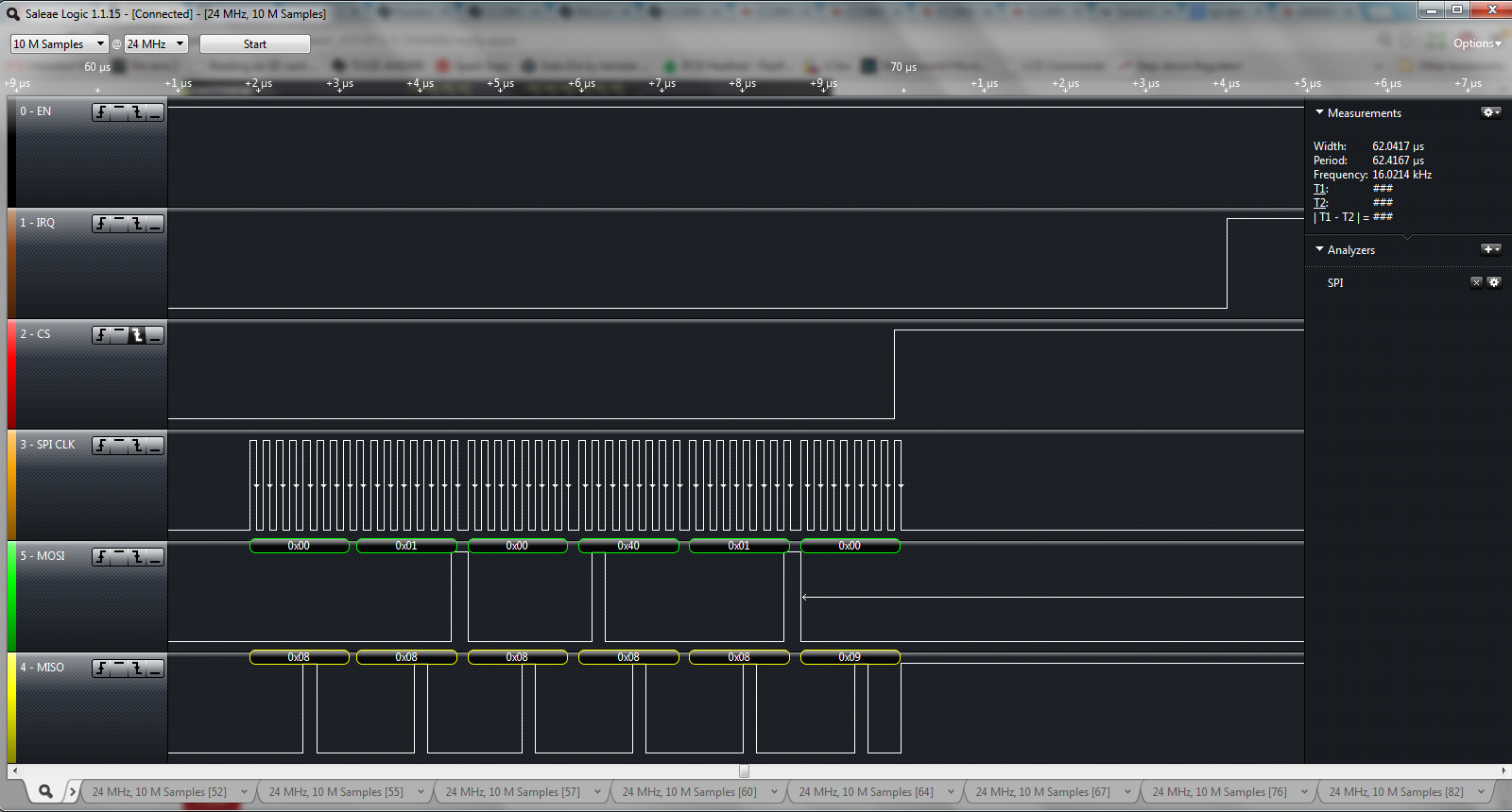

    3. Remaining 6 bytes of the first write (54.3us delay after the first 4 bytes)

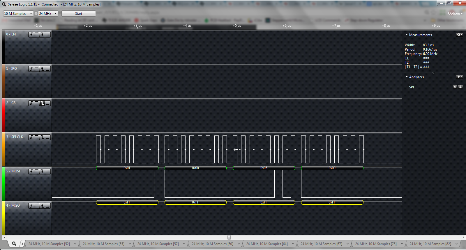

    4. first read for "command complete"

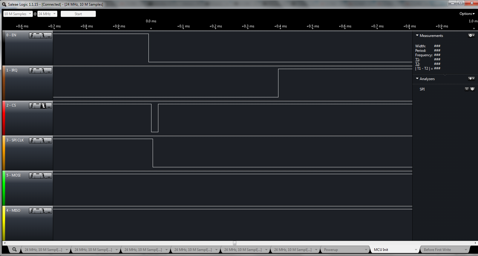

    I have a few more screenshot showing what happens before the first write, which might be of your interest.

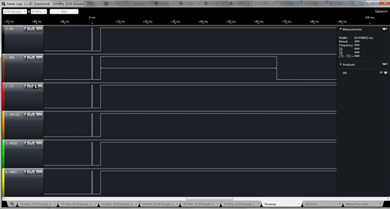

    1. Board Power Up. This is the waveform when the board is powered on. It seems there is already 63ms delay before IRQ drops low.

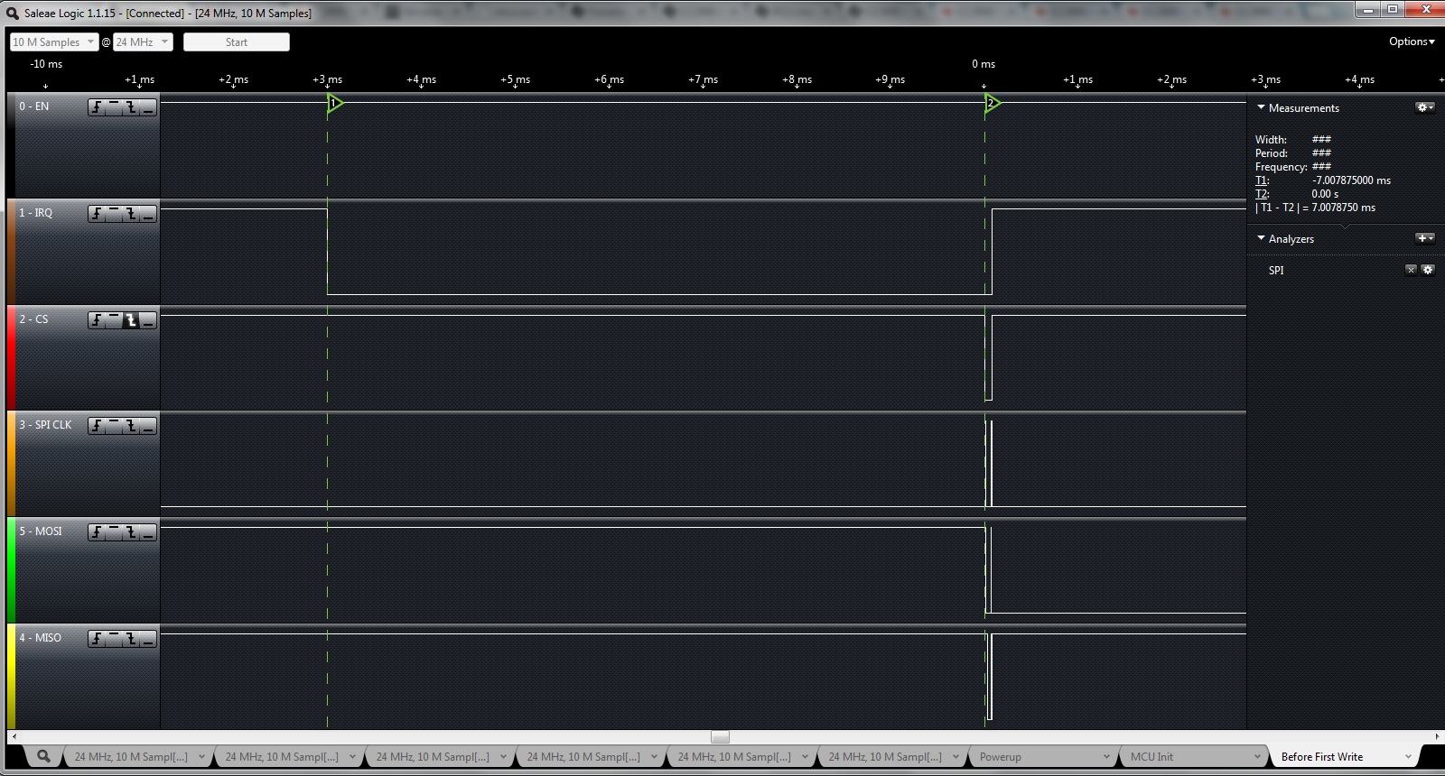

    2. Not util board is powered on, CCS could be run in debug mode. During this step, MCU starts to init; SPI peripheral is also initialized after that. This corresponds to WIFI_SPI_init() above.
    3. Execute the power on sequence of CC3000, referring to page 9 of CC3000 datasheet. Enable VBAT_SW_EN, wait until IRQ goes low. Wait for 7ms more before assert CS and carry out CC3000 init operation, as shown in SPI wiki page.
    The two short pulse on SPI CLK indicates the first 4 bytes and subsequent 6 bytes write, which has already been posted earlier.

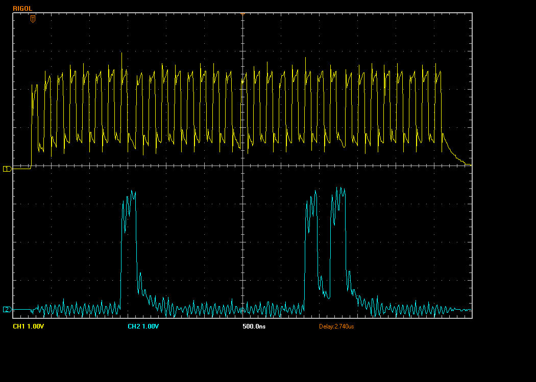

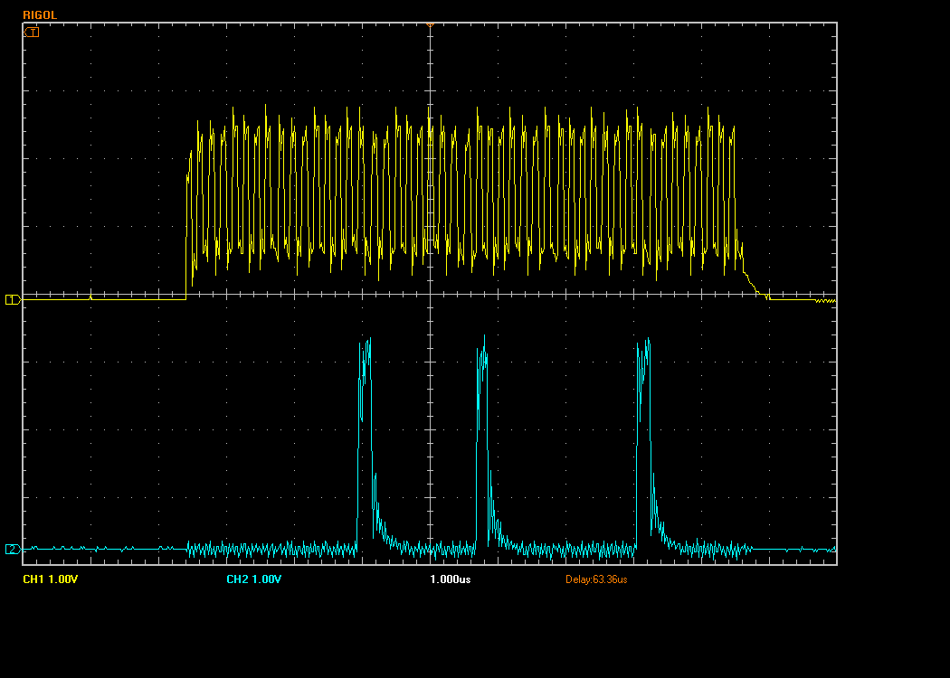

  • In addition to some pre-first-write logic screenshot, here are the real waveform about the first write. I have seen people in this post solving their problem by adding a capacitor on SPI CLK, making me thinking about potential signal integrity problem. The signals were sampled using Rigol DS1052E 50MHz scope.
    1. The first 4 bytes of SPI CLK (upper) and SIMO (lower)
    2. Remaining 6 bytes
    As can be seen the voltage of SPI CLK is lowered than expected for some reason, but it is still higher than VIH of 2V, so I guess it should be fine. There are also some ringing issue on both rising and trailing edge. I can add a RC snubber circuit to mitigate if that's necessary.

  • Dawei,
    I wouldn't trust the output of that SPI CLK, and it looks like it may trigger more times than intended. Also the level (especially on the first pulse) is too low to be reliable. Is there a way you could get these signals from your micro to come out better?
    Aaron

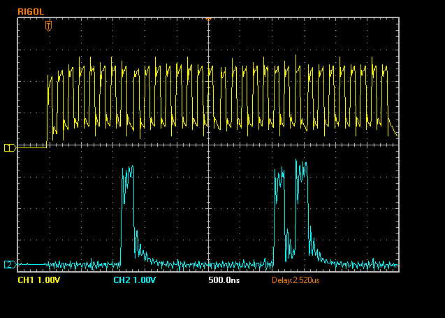

  • Aoran,
    This time I am probing the signals right beside the corresponding pins of CC3000, so I believe the waveform below would be very close to what CC3000 picks up. The signals shows less noisy which I guess is because of using two probe grounds this time. (I only grounded one probe on last measurement)
    1. First 4 bytes (updated)
    2. Start of remaining 6 bytes
    Other than resolution limitation in high sample bandwidth of this scope, I think the waveform on SPI clock is acceptable. Even for the first pulse, VIH is larger than 2V so there shouldn't be trigger problem.

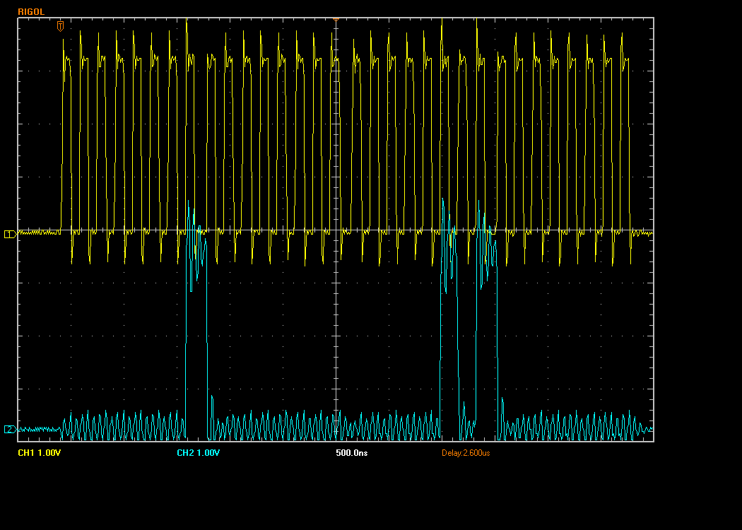

  • Hi Aoran,
    There was AC impedance for SPI CLK. After taking them out, the SPI clock could reach 3.3V. Here is how they look like for the first 4 bytes (probing beside pins of CC3000).
    I believe the waveform looks okay now.

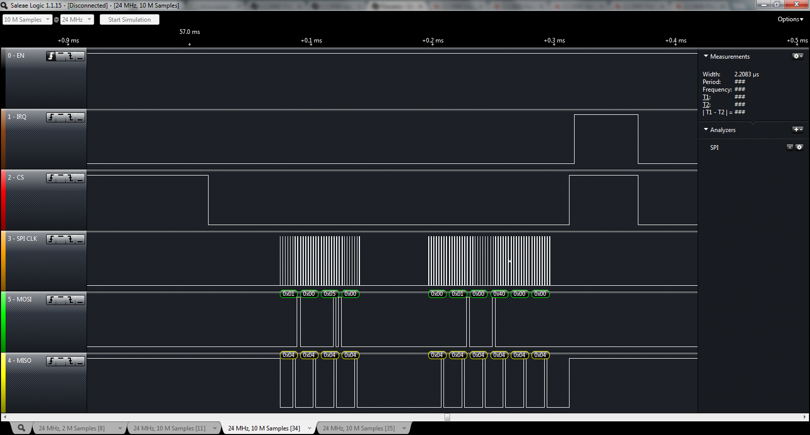

    Then I ran the codes in code composer studio with 50us delay after CS. However IRQ didn't drop as well this time.
    I have attached the entire data session for your reference.

  • It is time to conclude and close this topic. I finally found the problem, which has something to do with the CS glitch during MCU init ,as speculated in my previous post.
    This issue should only occur to those who use CCS to debug because the power on sequence of CC3000 now breaks into three steps, board power on, start CCS software, start MCU and CC3000 init. The problem lies in the first and last step. After board power up, IRQ should go low already, indicating it is ready to receive data. Meanwhile CS pin goes high by default. Then during the 3rd step MCU sets the direction of GPIO for CS and EN as output, and then write value 1 to them. However, the output of GPIO is low by default after direction being set, and this will create a very short high-low-high glitch on CS line. Refer to one of the pictures above showing the process WIFI_SPI_init().
    I believe it is this CS glitch that interrupt the internal state of CC3000 so that the first write never succeeds. The solution is to set init value 1 of CS before setting direction of this GPIO. That will make all the difference.
