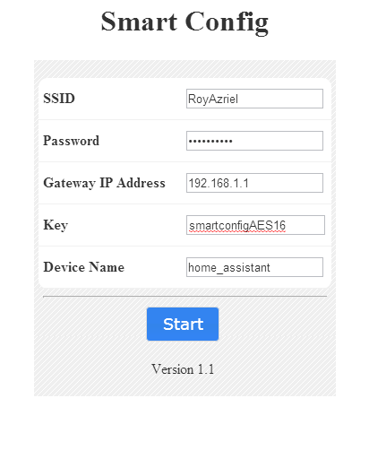

I am trying to run for the first time the BasicWifiApplication sample from 1.11 SDK on FRAM MSP430FR5739 with IAR workbanch.
all works fine to the point of starting smart config. using the uart terminal I select "01" in the menu to start the process, led 6 start blinking.
using jave applet( I configure my home AP details + encription and device -  see attachment ) clicking start. ( button changes text to working ) from this point and on nothing happens.
am I expected to do other steps before using the terminal ? do I need to verify something visually on the eval board ?

  • I am facing same issue. Start button gets converted in "Working" and nothing else happens.
    Same thing is working from Android App though!
    What are we missing?
  • BasicWiFi application have a problem with Smart Config. Smart Config can't complete. Because of that i will decide to use code of Smart Home Application. In that code SmartConfig work fine. Try it.
    And try to don't using encryption at frist time.
  • thanks.
    I tried also with home automation sample. same results - not connecting. is there another way you recommend ?
    Roy
  • Yes, i had same problem when i was started the work with msp430fr5739. I was solved this problem with patch update. Probably in yours controler is old version of patch. Download new patch v1.11 from  http://processors.wiki.ti.com/index.php/CC3000_Wi-Fi_Downloads#Patch_Programmer and when you instal patch on you computer, go to start->all programs->ti patch and download patch to controler. First download driver, than patch, and after that use home automation code for smart config.
  • But thing is Smart Config gets completed if I use Android App but It's not working with Java Applet. Even Java Applet v1.1 is not working.
    I don't know if I am missing out any thing. To summerize, Smart Config from Phones work but Smart config from my Laptop - No!
