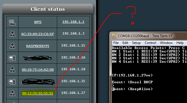

  • Funny, I didn't have that compiler option.  I tried this one --plain_char=unsigned, which IS supported and it doesn't seem to make any difference.
    Curiously, now that i'm connecting (I still can't seem to be able to send/recv data), the mac address looks funny - it's certainly not the same as on the sticker...
