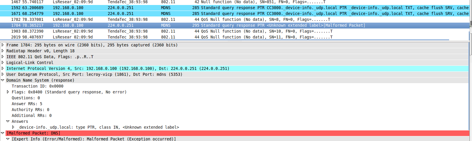

    Can you post code showing how you get the malformed packets?
    Aaron
    Sure:
      int i;
      int rc;
      for (i = 0; i < 4; ++i) {
        rc = mdnsAdvertiser(i != 2, "CC3000", strlen("CC3000"));
        cprintf("Result %d\n", rc);
        __delay_cycles(5 * 8000000UL); // Forced 5 second delay at 8MHz
      return 0;
    The console output is:
    > test
    Result 189
    Result 189
    Result 0
    Result 199
    The wireshark capture looks like:
    Peter

  • Sure.  The session is encrypted and was captured at the 802.11 level, so it may be you won't be able to decode this, though.  I don't know if there's enough info in the EAPOL exchange without also knowing the PSK.  The first three packets are from a previous session.
    This is another session, I'd already thrown away the previous one.
    Peter
  • Or maybe not.  TI doesn't like .capture as a suffix, and seems to have thrown out the tar file I wrapped it in.  Here it is in detailed XML format.
    If it doesn't show up again, the answer is no I can't post it.
    Did you try it and fail to reproduce the results?
