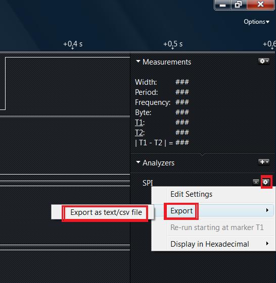

  • Just learned you can also export SPI data with Saleae Logic Analyzer.
    Here is the exported SPI data (exported to excel, then saved exchanged data as text file) from trace of first entry of this thread:
    8512.ray.txt
    Hope it helps and makes analysis easier...
  • That's awesome!  Thanks Martin!
  • In case you want to do it on your own:

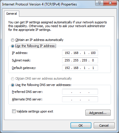

    I'll be honest with you - it seems like the model here is that users (such as myself) are doing the majority of debugging for the CC3300 module.  However, as a user, I would rather spend my time implementing new features for my product than debugging the WiFi module that I otherwise expect to just work.
    In this case, the test I am running that continues to produce failures is fairly straightforward.  I have a private network using static IPs, with two nodes on it, one of which is the CC3300.  The CC3300 is doing what is described in my initial post.  The other node is a PC running the following .NET application code:
    using System;
    using System.Diagnostics;
    using System.Net;
    using System.Net.Sockets;
    using System.Text;
    public class SynchronousSocketListener
        public static int Main (String[] args)
            StartListening ();
            return 0;
        private static void StartListening ()
            Stopwatch m_stopwatch = new Stopwatch ();
            // Data buffer for incoming data.
            byte[] rxBuf = new Byte[1024];
            // Establish the local endpoint for the socket.
            IPAddress ipAddress = new IPAddress (new byte[] { 192, 168, 1, 100 });
            IPEndPoint localEndPoint = new IPEndPoint (ipAddress, 80);

    3. Good question.  To test this, I left my router at 192.168.1.1, left my server at 192.168.1.100, but configured my CC3300 node to use DHCP rather than the static address of 192.168.1.101.  After 1 minute 37 seconds, I observed a faiulre where a connect message (opcode 0x1007) was never responded to.  So, yes, this seems to be an issue regardless of whether IP is static or dynamic.
    4. The .NET source that was posted assumes there is an active local endpoint with IP address 192.168.1.100.  If you don't have your wireless configured on your PC to use this static IP, you would see this exception.  Here's a picture of my PC wireless adapter IPv4 configuration:
