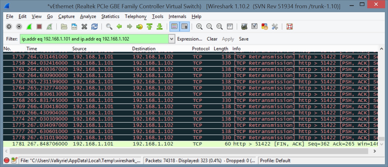

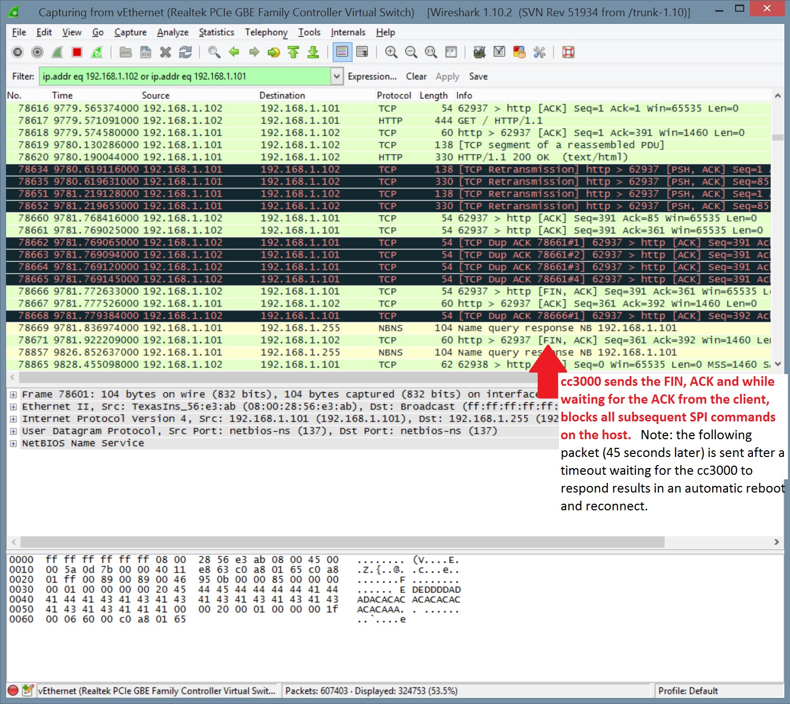

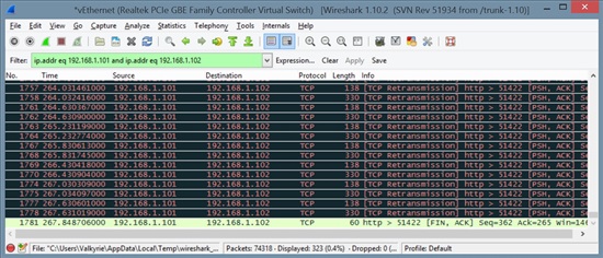

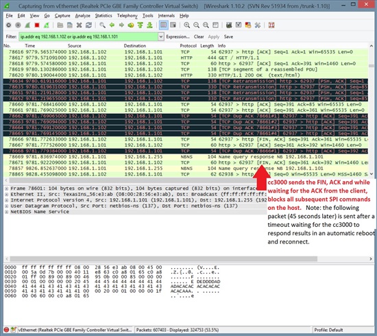

1.  Sometimes, the CC3000 sends a duplicate SYN+ACK  after the client already ACKed the first SYN+ACK.  I have seen this many times and posted about them in the past.
2.  A RST from the client should ALWAYS cause an immediate socket close and raise an HCI_EVNT_BSD_TCP_CLOSE_WAIT event.  In the example below, that duplicate SYN+ACK from the cc3000 causes the client to immediately RST (Reset) the connection.  The socket is now closed, and yet, the cc3000 continues as if the socket is open!  From the client API, there is no way to see that anything is wrong.

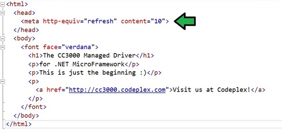

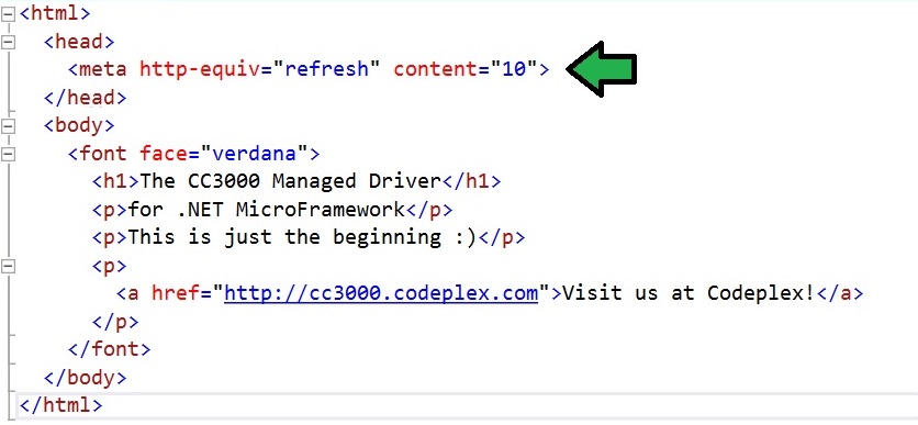

3. When I close the socket after some 10 seconds of inactivity, I call the socket method (HCI_CMND_CLOSE_SOCKET), but that causes the cc3000 to completely stop responding to all commands at that point.  The interesting bit here is that the cc3000 DOES send out the FIN+ACK to the client to close the socket (see the last packet in Part 2), so I know the close command was properly received by the cc3000 over SPI.  However, since the client already reset this connection, the client never responds and the cc3000 waits forever for the ACK that will never come.
Part 1 (Port 51422).  CC3000 running an HTTP server on port 80 as 192.168.1.101.  Client is Internet Explorer on 192.168.1.102.
Part 2:
I would recommend a few changes:
1. When you receive an RST from the client, close the socket on the cc3000 and raise this event: HCI_EVNT_BSD_TCP_CLOSE_WAIT
2. You must make the HCI_CMND_CLOSE_SOCKET a non-blocking call.  There are situations where the client may never respond, rendering the cc3000 completely dead until it is power cycled.
If these issues are not fixed, I don't see any way that the cc3000 can EVER be used as a reliable server.  I don't see any way to detect or workaround this.  I have more captures as well showing other times this has happened.  I could set the socket timeout option, but that won't solve the problem, as the cc3000 will still hang waiting for the client to ACK the FIN+ACK sent by the cc3000 when the socket close is attempted.

    In my case, the server "sends" 5 packets - all send() calls are successful. Meanwhile the client sends FIN+ACK, then opens another connection with SYN. WiFi module tries to respond to the old connection (as it didn't see FIN), then the client sends RST packet because the connection is closed on its side. After the last send(), module did not raise HCI_EVNT_BSD_TCP_CLOSE_WAIT, neither HCI_EVENT_CC3000_CAN_SHUT_DOWN event. Even if waiting for shutdown is skipped, the closesocket() freezes at SimpleLinkWaitEvent(). Also, any other command (such as accept or select) blocks indefinitely. This is repeatable.
    In the end, we're wasting our time debugging the module that IMHO should work out of the box.
    Valkyrie sent another post exactly a month ago. Still no single answer from TI employees. Could you at least reply that you're investigating the issue? Or that it's not an issue/whatever, because we're waiting here for your answer, trying to develop something based on your module.

    I currently run an http server from the cc3000 and have it respond to all GET requests with a web page.  The web page is a simple string:
    var body = "<html><head><meta http-equiv=\"refresh\" content=\"10\"></head><body><font face=\"verdana\"><h1>The CC3000 Managed Driver</h1><p>for .NET MicroFramework</p><p>This is just the beginning :)</p><p><a href=\"http://cc3000.codeplex.com\">Visit us at Codeplex!</a></p></font></body></html>";
    I will typically run my HTTP server and leave the browser open to this page, which contains an auto refresh every 10 seconds.  I leave this running for as long as possible and review the logs to determine what caused the failure.  The goal for me is to get to the point that it runs indefinitely.  If it runs for 3 weeks without dying, I will call that a success.  So far I have not gotten much past 2 days.  When it fails, I look at Wireshark and the logs to see what happened, and this reset issue is a common cause of failure for me.
    Aaron, can you add the refresh option with a 10 second interval to the web page you serve?  Then leave the server to serve web pages continuously, overnight.  It should still be refreshing the next day.
    -Valkyrie-MT

  • I am running the cc3000 with wireshark almost around the clock.  Every time is fails, I look at the logs and wireshark to see what happened.  I think every single failure is ultimately because of the blocking socket close.
    Here is another example of the blocking socket close:
    The cc3000 sends the FIN/ACK to close the socket.  But, while it is waiting for the client to ACK, it does not respond to any SPI commands.  The cc3000 must never block here.  You can never guarantee that you will get a response.  I am just re-iterating change suggestion #2 from my first post.
    Also, I would like to make one more suggestion to TI.  We really could use a TCP/IP stack Reset command.  The command would just reset all the sockets to an initialized state, just like if it was power cycled.  However, it maintains the wifi connection so it is quick, the assigned IP is preserved, and the client may never even notice.  As it is now, the only way to reset is to toggle the PWR_EN pin and this forces a time consuming wifi reconnect which could mean the IP changes and clients have to change address.  It's a very drastic thing to have to do, but when the cc3000 stops responding, I have no alternative.  We need a better alternative here.  The cc3000 does not need to be perfect if there is a way to reset the sockets without reconnecting.  Ideally, I'd love to be able to reset individual socket IDs, but I'm not picky.
    Thanks.
  • Hi Valkyrie,
    What technique are you using to auto refresh in IE11?
    Aaron
  • I have inserted a meta refresh tag into the head section of the html file.  Once you serve a file with that tag to IE (or other browsers), it will automatically refresh the file.
    Here is an example:
    The content specifies the number of seconds between refreshes.  To stop the refreshing, just click the web browser's stop button.
    -Valkyrie-MT
