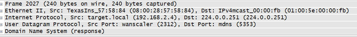

1. When sniffing with Wireshark I notice the source port is incrementing by one every time and starts at different values and gets hung up on different values.  When looking at all other packets from other vendors with mdns the source port is always the same as the destination port - 5353.  TI - why is this not hard coded to 5353.  This could easily be the problem if every time mdns broadcasts it opens a new port to do so.
2. The point where the CC3000 quits sending mdns packets varies but for me seems to be around 7-8 minutes when calling mdns every 6 secs.  Sometimes it will start sending again and sometimes it does not.

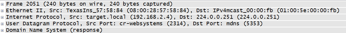

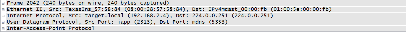

    4. I need an answer on why the source port is incrementing -- THIS IS MAJOR! (see example below)
    Here is my capture of 3 packets that demonstrate the source number changing according to Wireshark at least:

    The port number increase should be fine I think. As it follows UDP and source port should not be of much significance. It is just a port on which a reply is expected in required cases.
