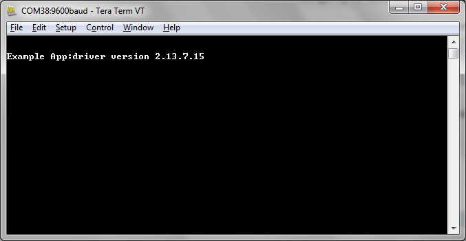

i am following the instruction of  "http://www.ti.com/lit/ml/slab067/slab067.pdf" to RUN Wifi Example.
I am able to see the driver version on Terminal.
But when i send cmd "03" i am not getting "DONE"  response.
what could be the problem?

  • Hi Raghavendra,
    I am not getting the sequence to proceed.
    Step1 : I plugged my launchpad  to PC
    and opened Terminal. when i press reset button "Example App:driver version 2.13.7.15" displayed on the Terminal
    Step2 : I opened the Android smart config App. It auto detects my SSD "String name" then i entered password.
    Step3 : In this step should i need to enter key "1" or not? if i give key value "Start" button is Disabled in android smart config app.
    Step4 : Sending command "01" from hyper terminal , no luck
    Is this a correct sequence to config?
    please help me !
    thanks,
    Ashok r
  • Hi Ashok,
    As you are using MSP430G2, you cannot use encryption in SmartConfig.
    For other platorms, at step 3, you should provide the key as "smartconfigAES16". This is the same key defined as 'smartconfigkey[]' in the BasicWifiApplication. And then press Start.
    But here as you cannot using encryption, please make sure that you are calling 'wlan_smart_config_start(0)'. Passing a '0' means you are using SmartConfig without encryption. Passing a '1' means you are using encryption.
    Therefore, on the Smartphone application do not put anything inside the 'Key' field. Enter the password and press 'Start'. After this send command "01" on the hyper terminal.
