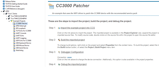

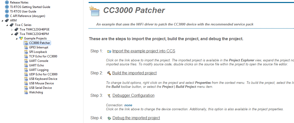

in CCS I go to the welcome page, I set Packages = TI-RTOS, then ARM/Tiva C Series/Tiva TM4C123GH6PM/Example Projects
Here you have CC3000 Patcher, TCP Echo for CC3000, UDM Echo for CC3000.
My idea is to start with CC3000 Patcher then move to the other examples.
