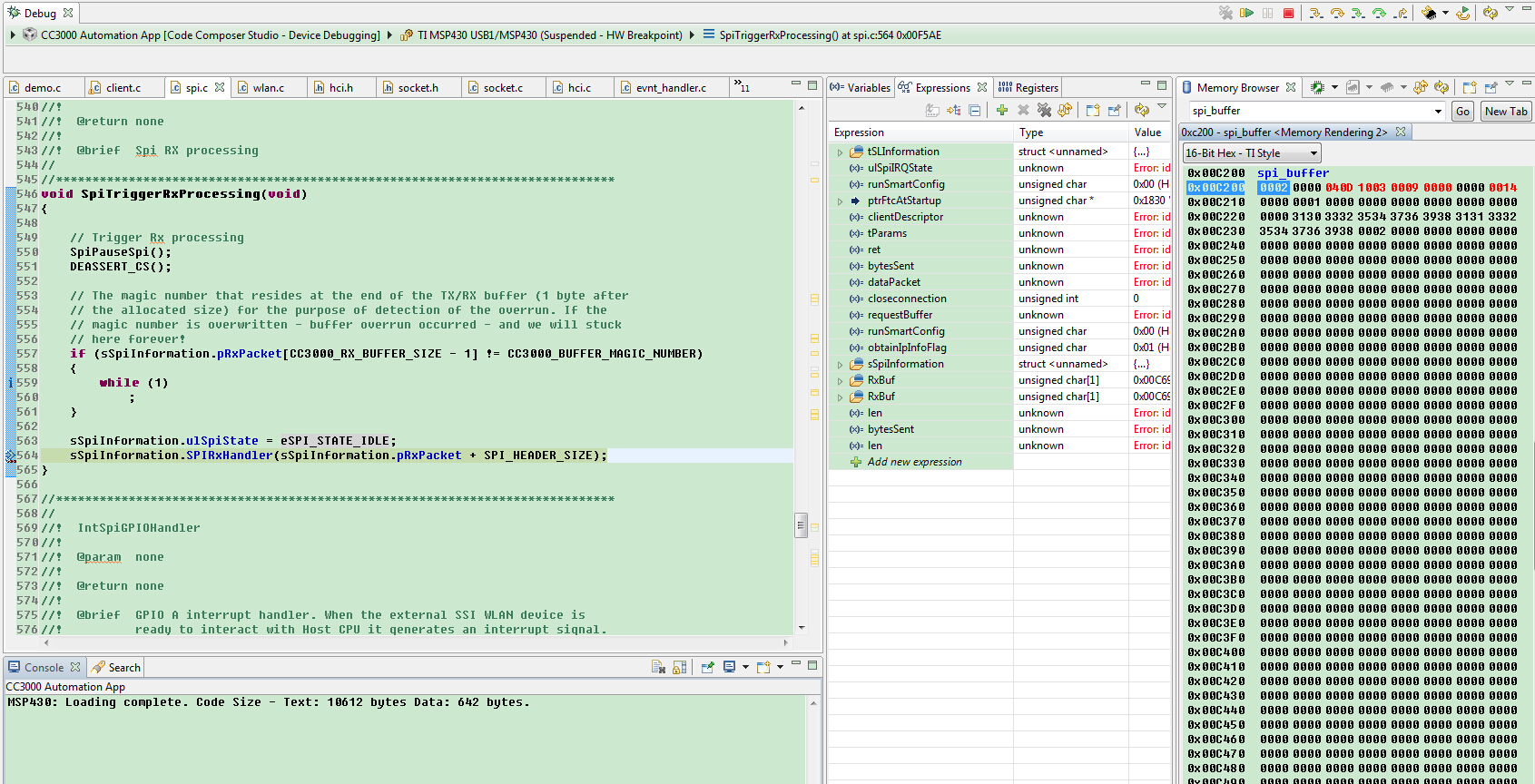

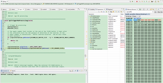

  • By the way, I did the patch driver/firmware when i was doing home automation, for basic wifi application, do i need to do the patch too?
  • After futher analysis, I found the SPI recevice buffer difference between the Home Automation and Basic WiFi Applicaiton. Once the HCI_CMND_SEND(0x1003) has been sent to CC3000, it will get response two times from CC3000, i can see the IRQ was triggerred two times, which means the CC3000 responsed two times.
    Here are the two picutures i captured to show the spi receive buffer in Home Automation project. But for Basic WiFi Application, there is only one time of receiving from CC3000, and it was approved that I can only see the IRQ was triggered one time. The second picture is the same as i got in Basic WiFi Application, as you can see, the command is to free the buffer (0x4100, HCI_EVNT_DATA_UNSOL_FREE_BUFF), and i traced the code, approving it is the reason why the code got stuck.
    But I still do not know for the configuration of MSP430F5232 + CC3000 with Basic WiFi Application, it only receives one time of spi buffer after sending the HCI_CMND_SEND command.  Is it because I have not patched the CC3000? The CC3000 with MSP430FR5736 had been patched before.
