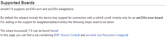

    If you are using SDK7, you will not require this file the ST will take care of the GPIO
    you can try the SDK7 + bluetopia pre-built images from
    http://processors.wiki.ti.com/index.php?title=WL18xx_AMxxx_platform_integration_guide#prebuilt_images

    If I understand correctly you are using COM8 module ( http://www.ti.com/tool/wl1835modcom8b ), right?
    I have tried it myself using the prebuilt images on am335x EVM + COM8 I did not face any problem.
    Make sure you have downloaded the images from
    can you also make sure that you are having the Service pack in the location "/lib/firmware"

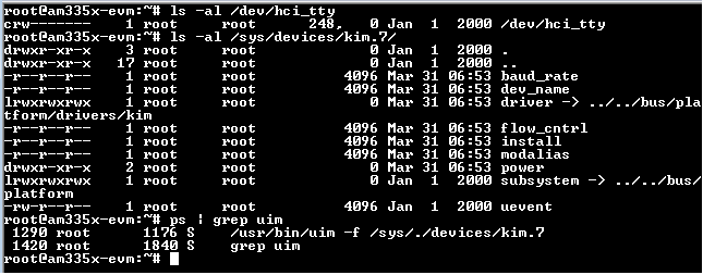

  • I'm not trying to take over the thread, I just wanted you to know that I'm following this as well, and it is at least as important to me as it is for the fellow who originally posted.
    It worked for me as it did for you until the AUDM>9 1 command.  At that point I get the same DEVM_PowerOnDevice error message as above (Failure -14, Unknown Error.).
    (I will be using SPP for my application, but the SPPM behaves the same way as the AUDM at the point SetDevicePowerOn is issued.)
  • I looked through the boot messages for problems.  Maybe something here will help.
    One error is that it is looking for files in the path /lib/modules/<long version number>+, but the real path doesn't end with the plus (+).  I made a link with the + added and no error is being reported.
    Another error the boot process reports is that there is no "uEnv.txt" file.  Should there be one (using the SK)?

    As mentioned earlier I have downloaded it from the below location boot partition and root partition.
    http://processors.wiki.ti.com/index.php?title=WL18xx_AMxxx_platform_integration_guide#Prebuilt_images
  • I know  am using SK, and you are both using EVM, but the difference in build dates is unexpected.  The EVM was built 30 MAR, the EVM-SK built 17 JUN.  This doesn't seem right.  THE EVM-SK IMAGE WAS BUILT 3 DAYS BEFORE PUBLISHING.  I can confirm I downloaded these images two days ago from the exact same link you specified above.

     In my boot log I am getting a message " bluetooth: disagrees about version of symbol module_layout "
    What could be the reason for this?
  • I missed these two items.
    1. At the very beginning of the boot process:
    U-Boot SPL 2013.10-g78d8ebd (Mar 30 2014 - 20:46:34)
    reading args
    spl: error reading image args, err - -1
    reading u-boot.img
    reading u-boot.img
    U-Boot 2013.10-g78d8ebd (Mar 30 2014 - 20:46:34)
    2. The first time I execute the SetDevicePower command, the response is more detailed:
    SPPM>1 1
    BTPM_Initialize() Success: 0.
    DEVM_RegisterEventCallback() Success: 5.
    SPPM>8
    DEVM_QueryDevicePowerState() Success: Off.
    SPPM>9 1
    [  382.206536] (hci_tty): inside hci_tty_open (cd26c608, cc03ca40)
    [  382.212894] (stc): gdata/new_proto/recv or reg_complete_cb not ready
    [  382.219434] (hci_tty): st_register failed -22DEVM_PowerOnDevice() Failure: -14, Unknown Error.
    Function Error.
    SPPM>9 1
    Function Error.
    SPPM>
  • One problem with the downloaded images is that the boot process tries to load from /lib/modules/3.12.10-ti2013.12.01+ and fails.  There is only the directory /lib/modules/3.12.10-ti2013.12.01.  I created a link to fix this.
    This did not fix the Bluetooth/Bluetopia SetDevicePower issue.
    All but two entries in /lib/modules/3.12.10-ti2013.12.01 are dated 17 JUN, and there are two links to a non-existent directory.  'grep -i bluetooth *' shows lots of hits in the files in this directory.  What was published 20 JUN is definitely not the 30 MAR built firmware you are running.
    It really looks to me like someone's development code was accidentally published as finished code.

    Also with regard to the:    ls -al /dev/hci_tty       I see:
    crw-rw----     1 root      root               248,       0   Jan   1 00:00    /dev/hci_tty
    HOWEVER with the ls -al  /sys/devices/kim.12
    I only see:
    drwxr-xr-x    3 root     root             0 Jan  1 00:01 .
    drwxr-xr-x   21 root     root             0 Jan  1 00:00 ..
    -r--r--r--    1 root     root          4096 Jan  1 00:01 modalias
    drwxr-xr-x    2 root     root             0 Jan  1 00:01 power
    lrwxrwxrwx    1 root     root             0 Jan  1 00:01 subsystem -> ../../bus/platform
    -rw-r--r--    1 root     root          4096 Jan  1 00:01 uevent
    For the ps | grep uim:   (I do not see what you see !!)
    -bash-4.2# ps | grep uim
     1000 root      2572 S    grep uim
    Hopefully, there is some indication of what is awry from the above information.

    I see the only listing items in /sys/devices/kim.12/
    are: modalias    power    subsystem  uevent
    How/where do the rest of the elements get generated:
    baud_rate     dev_name   driver     flow_cntrl   install
    I see all those elements in the device tree but somehow they are not getting generated/created in /sys/devices/kim.12
    Mike

    Are you using SDK7 or SDK6?
    If you are using SDK7 then I think you are using the wrong Bluetopia code (http://www.ti.com/tool/linuxezsdk-am335x-wilink8), as it should call /dev/ttyxxx, instead of gpio_en.ko(no more part of SDK7).
    and if you are using SDK6, then gpio_en.c (gpio_en_am335x.c) is part of the Board-support/extra-drivers/bt-enable-1.0, which need to be built and the gpio_en.ko should be placed in the desire directory.
    I am using SDK7, linux-3.12.10 and the Bluetopia code found in http://www.ti.com/tool/linuxezsdk-am335x-wilink8.  I am trying to call /dev/ttyO1 - NOT gpio_en.ko-.  I understand that it is not part of SDK7.  My problem is that kim_probe() is not being call early in the linux start-up sequence.  Why not? I have all the patches that are described in WL18xx AMxxx platform integration guide.

  • Hi Joseph,
    I thought the documentation ( WL18xx AMxxx platform integration guide) said to use linux-3.12.y plus the recommended patches.  I went and got the source from "Commits in ti-linux-kernel/ti-linux-kernel/ti-linux-kernel:linux-3.12.y"  [Source tree]   Just for comparison I decided to take a look at the source in the zip  containing BSP Source Code.  This is the code inside "am335x-evm-sdk-src-07.00.00.00.tar.gz" .
    What a radical difference when doing a "diff" !  Ok - as soon as I started swapping out the sources with that source found in am335x-evm-sdk-src-07.00.00.00.tar.gz ,  the shared transport function worked.
    I am guessing I just have to get the source for everything else up-to-date and I will start seeing results.
    Michael
