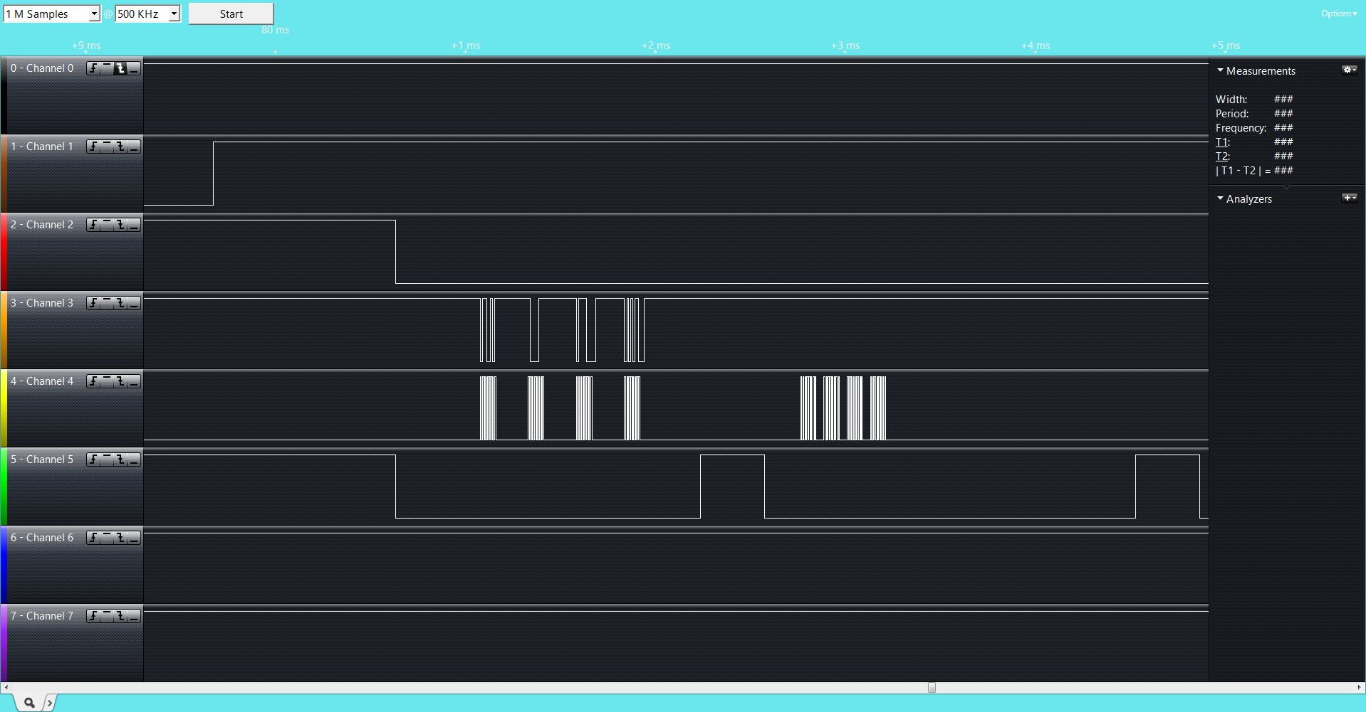

  • Here is a waveform of the first write and read.  It write 65 87 78 56 and then reads zeroes over and over until it gives up on getting a sync code and enters an assertion failure spin loop.
    Signals are EN (nHIB), IRQ, MOSI, MISO, CLK, CS.
    Any suggestions?
  • Fixed my problems with SPI by setting both these to zero in SPI_CTAR register:
    SPI_CTAR_CPOL_MASK
    SPI_CTAR_CPHA_MASK
    Hope this helps.

  • After researching another issue on another thread here I realized my main problem. My voltage regulator was not strong enough to power the K10 MCU and the CC3100BOOST at the same time. It is 0.5 amp. I added power by plugging the USB connector and changing the jumper and now everything works great.
