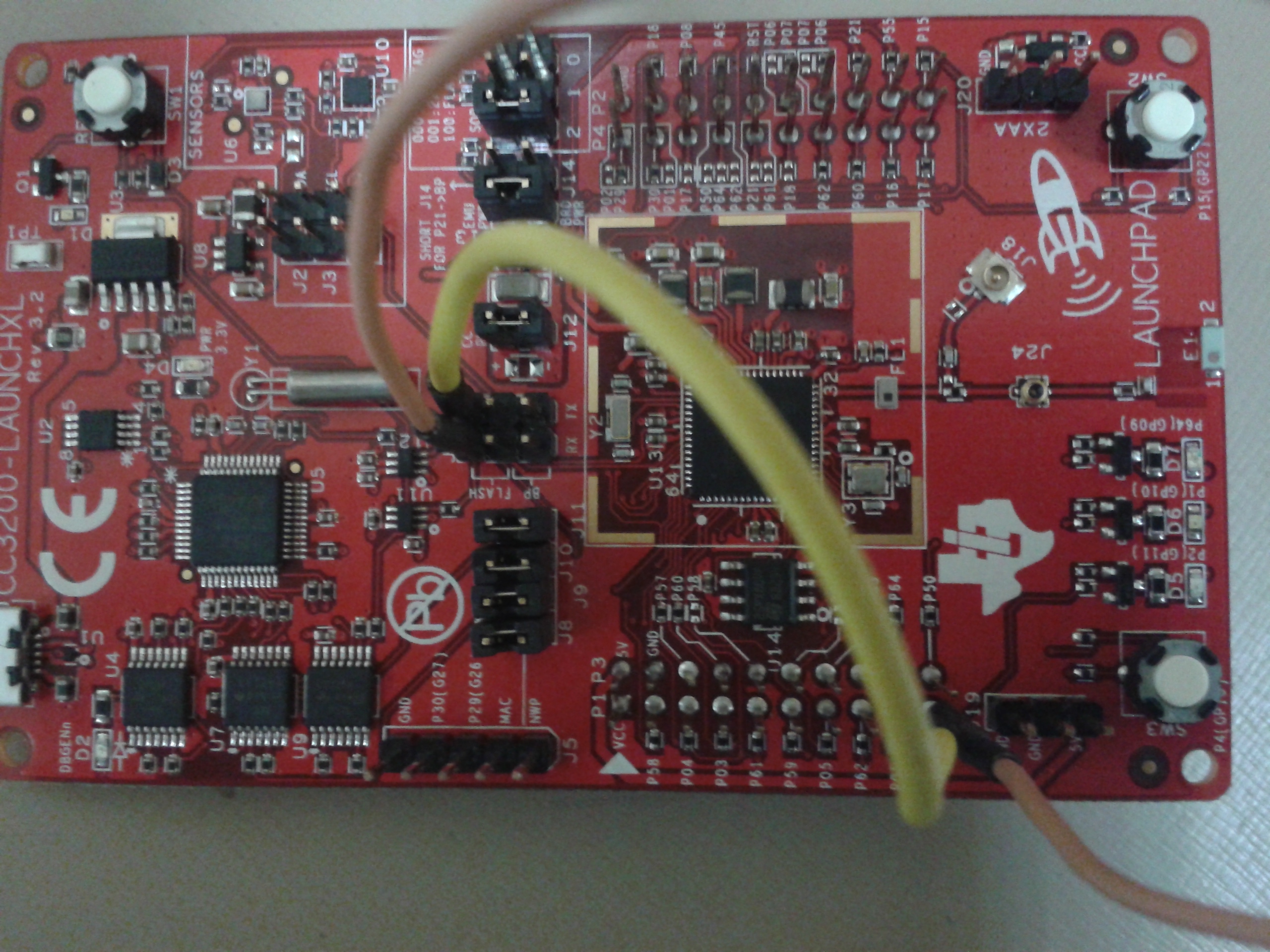

  • Dear Praveen,
    I'm Chan. I've started working on CC3200 launchpad a week ago. Your replies on "UART problem" helped me to quickly configure UART0 to external RS-232 transceiver as follows.
    a. Removed the jumpers on J6 and J7.
    b. Connected middle pin of J6 to Rx and middle pin of J7 to Tx.
    c. Power pins of external RS-232 transceiver are connected on P3-1 (+5V) and P3-2 (GND) of CC3200LP.
    Now, I want to use another UART also simultaneously in my application. Please help me by providing the following information.
    1. Is the above configuration is correct ?
    2. I want to retain the USB connection to Computer for debugging. Hence, J6 and J7 are to be connected. If they are connected, what are the alternative PINs for Rx and Tx of UART0. The idea is to run application in MCU without removing USB cable from PC (However, SOP2 shall be removed and Reset button shall be pressed).
    3. In short, please let me know the Pins for UART0 and UART1 when J6 and J7 are connected. Also let men know another set of +5V and GND connections for 2nd RS-232 Transceiver.
    4. Kindly provide the modifications in "uart_demo" example to use UART0 and UART1 simultaneously to connect two separate RS-232 devices.
    Thanks & Best Regards
    Chan
    I've connected UART0 through USB while J6 and J7 are connected. UART1 is connected on P1-2 and P1-6.
    In the uart_demo example of cc3200 sdk, I've duplicated UartGetChar(), UartPutChar(c), InitTerm(), ClearTerm(), Message() and Report() functions for UART1 just by changing CONSOLE to CONSOLE1.
    Now, I could send and receive characters on both UARTs SEQUENTIALLY where I need it be SIMULTANEOUSLY.

  • Hi to All,
    I am Trying to connect the  cc3200  Uart 0 to my system terminal software and to get output but i can't able to get ouput .
    I am Connecting the RX and Tx Pin in PORT 1  3 and 4 Respectively.And Change the Jumper on J6 & J7 to Normal UART mode.
    I attach my coding in this message
