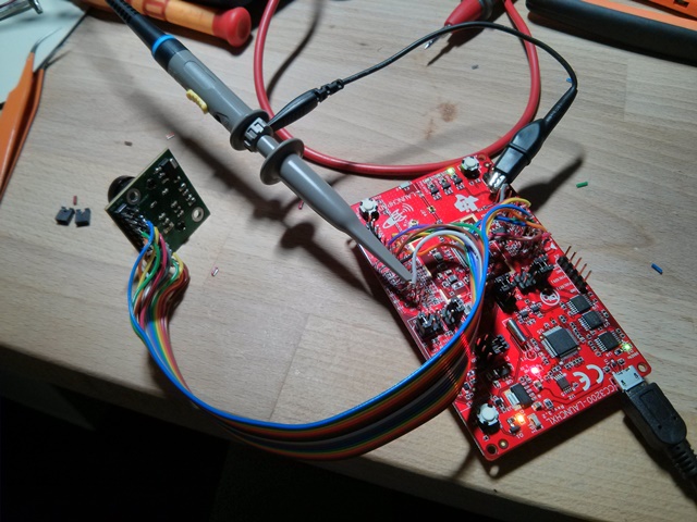

The webpage is being served with the default image, and I can see camera data flowing down the lines on the oscilloscope.
This is however where I hit a snag.
The webpage loads, and the camera data is clearly going into the chip (data lines seem good, clock and HSYNC, VSYNC all good, I2C config happens at boot).
However, I never get the image out, the webpage just shows a null (blank) image when I click the button to grab an image.

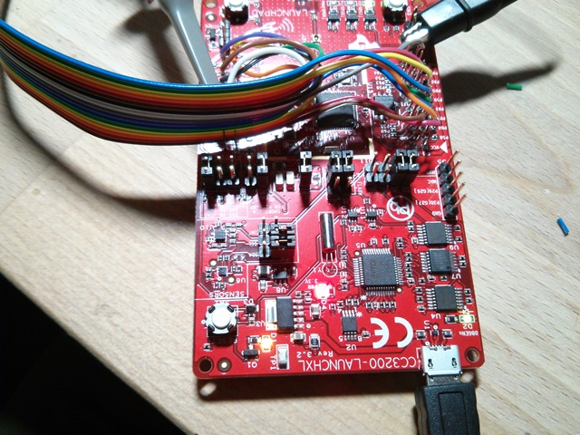

I have attached images of the jumper configuration I have it currently running with.

  • Llia,
    Is your device in force-AP mode - Can you please ensure P58 and VCC are not connected? I'd also want to check if you are getting a frame-end interrupt at first place - Can you please put a breakpoint in 'CameraIntHandler' where 'g_frame_end' is set and see if its getting hit? Also, if you have an LA, a screenshot showning the data-lines, VS and HS will help.
    -Praneet
  • Hello Praneet,
    Thank you for answering so quickly.
    On the "status" tab of the main.html page, it shows the device in Access Point mode.
    Not sure exactly where to force AP Mode...
    Pin 58 is only connected to D3 data line from camera, and it seems to be getting data.

    1. Using the Logic analyser, I can clearly see that camera outputs nothing on startup. It is then fed I2C commands, and begins to output data.
    2. This data all looks valid. In the following image we have:
    D3: HRef      D4: Vsync      D5: XCLK    D6: PCLK   D7-D14: 8bit data
    We can also see that Href and Vsync do what they should:

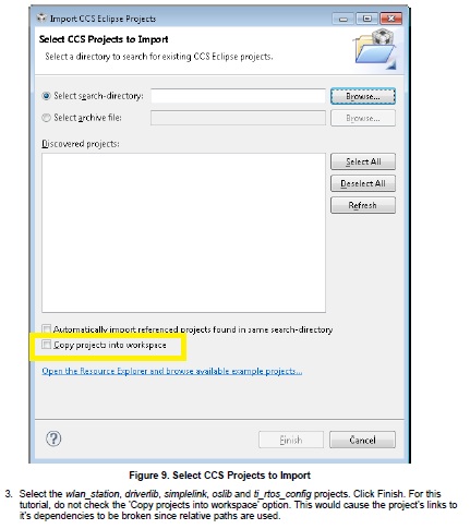

    Regarding CCS compilation issues, I guess it is due to a common practice of existing CCS users to
    "copy the project in workspace"
    Please check above guidelines from CC3200-Getting_Started_Guide.pdf and see if it helps solve your problem.
    In next SDK 1.0.0, above limitation is addressed and user should be able to import and copy project in workspace.

    On using File->Import->CCS project->browse and select Camera Application->Ensure "Copy into workspace ins unchecked" I get:
    Description Resource Path Location Type
    fatal error: datatypes.h: No such file or directory camera_app.c /test1 line 47 C/C++ Problem
    fatal error: datatypes.h: No such file or directory main.c /test1 line 58 C/C++ Problem
    fatal error: hw_types.h: No such file or directory startup_ewarm.c /test1 line 39 C/C++ Problem
    fatal error: hw_types.h: No such file or directory mt9d111.c /test1 line 47 C/C++ Problem
    fatal error: hw_types.h: No such file or directory pinmux.c /test1 line 46 C/C++ Problem
    gmake: *** [camera_app.o] Error 1 test1 C/C++ Problem
    fatal error: hw_types.h: No such file or directory i2cconfig.c /test1 line 46 C/C++ Problem
    gmake: *** [i2cconfig.o] Error 1 test1 C/C++ Problem
    gmake: *** [main.o] Error 1 test1 C/C++ Problem
    gmake: *** [mt9d111.o] Error 1 test1 C/C++ Problem
    gmake: *** [pinmux.o] Error 1 test1 C/C++ Problem
    gmake: *** [startup_ewarm.o] Error 1 test1 C/C++ Problem
    gmake: Target `all' not remade because of errors. test1 C/C++ Problem
