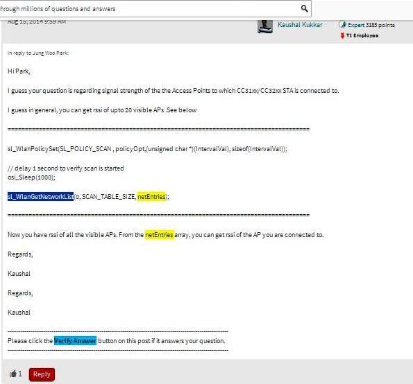

  • Hi Park,
    I guess your question is regarding signal strength of the the Access Points to which CC31xx/CC32xx STA is connected to.
    I guess in general, you can get rssi of upto 20 visible APs .See below
    sl_WlanPolicySet(SL_POLICY_SCAN , policyOpt,(unsigned char *)(IntervalVal), sizeof(IntervalVal));
    // delay 1 second to verify scan is started
    osi_Sleep(1000);
    sl_WlanGetNetworkList(0, SCAN_TABLE_SIZE, netEntries);
    Now you have rssi of all the visible APs. From the netEntries array, you can get rssi of the AP you are connected to.

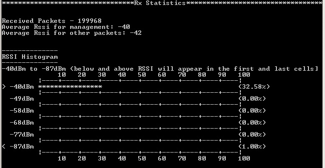

    Below is a short exmaple:
    sl_WlanRxStatStart();// start collecting Rx Statistics data
    sl_WlanRxStatGet(&gRxStatResp,0);// Read statistics
           printf("\n\n*********************************Rx Statistics**********************************\n\n");
    printf("Received Packets - %d\n",rxStatResp->ReceivedValidPacketsNumber);
           printf("Average Rssi for management: %d\nAverage Rssi for other packets: %d\n",rxStatResp->AvarageMgMntRssi,rxStatResp->AvarageDataCtrlRssi);
    You can also print the RSSI Histogram of the last received packets.
    I hope it answers your question.
