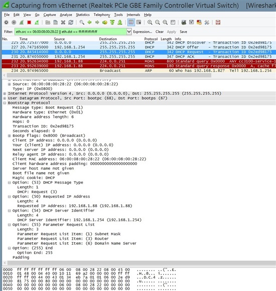

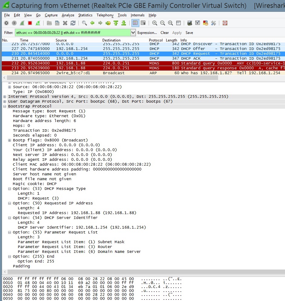

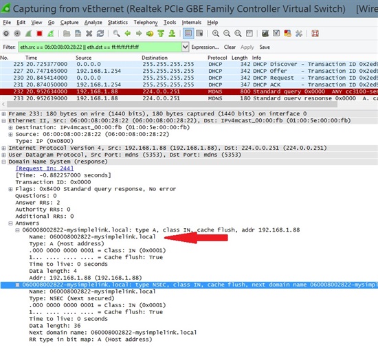

  • Ok, so I went into Wireshark to check things out.  First, I can confirm that the cc3100 does not send the hostname in the DHCP negotiation.  It should be Option 12 like this from another device:
    Here is the option list from the cc3100:
    Also, with respect to the local name resolution, notice the second red line there?  That is the mDNS A record broadcast and sure enough it shows the local name to be <MAC address in hex>-mysimplelink.local.  So for me, entering http://060008002822-mysimplelink.local into my iPad worked perfectly!  The mDNS service actually responded to the iPad's name request perfectly.  Now the only detail is figuring out how to change it from this name to something relevant to my device.  Here is what the response looks like from the cc3100:

  • Hi Chris,
    Yes, Glenn is correct.  I have confirmed it with Wireshark.  Setting the Device URN with the NetAppSet command does set the mDNS A Record for local name resolution of the web browser.
