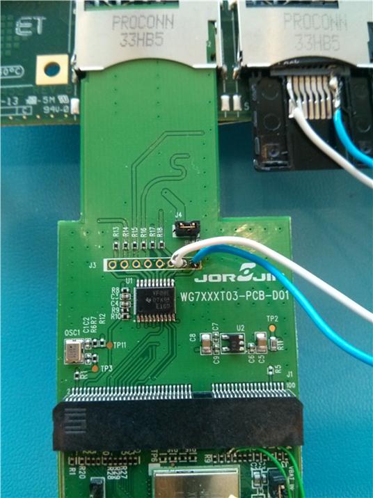

  • Hello, everyone,
    I have the same board and wl1837 module. Can anyone provide me its data sheet (wg7xxxT03-PCB-D01)
    Are the two jumpers for WLAN_EN and WLAN_IRQ pins? If yes, please tell me which one is WLAN Enable and WLAN IRQ in particular.
  • Hi Amna,
    The blue wire is WL_EN and the white WL_IRQ. You also need to remove R19 so that WL_EN is not driven on adapter board by Vcc.
    Iain
  • Thanks a lot for the information Iain. I really appreciate your quick response.
  • Hello lain,
    I have one question relating WLAN_EN pin. In your reply, you have told to open jumper R19 for controlling WLAN_EN pin but I guess , to control WLAN_EN pin , there are some other settings too since I am unable to control WLAN_EN pin via GPIO pin of twrvf65gs10, although the output on GPIO pin is being correctly measured via digital multimeter. GPIO pin controlling WLAN_EN pin is showing correct voltage but when it is connected with WLAN_EN pin on JORJIN module after opering R19 jumper, Wilink8 card is unable to get detected. I have to close the jumper R19 to work with Wilink8 card via JORJIN WG7XXX module. This causes limitation in controlling WLAN_EN pin for power on/off of the WLAN module.
    Amna
  • Amna,
    The key thing from a WiLink8 point of view is that the WL_EN signal must be driven high by a GPIO after the VBat line has gone high and after the 32k clock is active. This is required for the WiLink8 to detect the WL_EN going high.
    See diagram in section 5.12.2 of datasheet http://www.ti.com/product/WL1835MOD/datasheet/specifications#SWRS1526759
    Typically this is done via the device tree file using a fixed_regulator structure to drive the GPIO when the MMC device driver is loaded as this ensures there is a delay after power and clock is applied. See http://e2e.ti.com/support/wireless_connectivity/f/307/p/356133/1309947.aspx#1309947  for details from i.Mx6.
