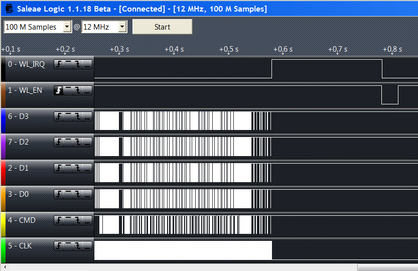

sdio read failed (during ifconfig wlan0 up)
Other Parts Discussed in Thread: WL1271
Can anyone provide insught into what the problem could be here?
These messages for a WL1835MODCOM8 board connected to Xilinx Zynq host
(The wlcore driver loaded correctly on boot-up)
ifconfig wlan0 up

Should I be reducing the SDIO Clock frequency (presently clocked at 50MHz)?
What else should I Be looking at?
The host interface signals appear ok

  • Hi Peter,
    The DT patches for the WL8 drivers can be found in: https://gforge.ti.com/gf/download/frsrelease/1161/6994/dt_pathces.zip
    I recommend that you take a look...
    Gigi Joseph.

  • Hi Peter,
    How about the Pin Mux settings?
    On our reference platform, it is as below:
