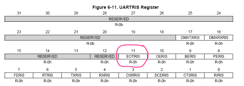

I tried to create a Rs485 interface with Cc3200 uart1. Unfortunately there seem to be no mode to create a "transmit enable signal" by hardware, a signal to connect to DE (drive enable) in a Rs485 transceiver. So I use a gpio, setting it before writing data to the transmit fifo. But now, I need an End-of-transmit irq to clear it after complete transmission. Obviously there is one eot-irq, but I never have never seen eot bit beeing set in raw interrupt status Register.
I use the UART example of cc3200 sdk. Fifos are enabled. Eot bit is cleared in control register, so txris acts upon fifo levels. Eot is set in irq mask register. I expect eot IRQ to trigger, when fifo is empty and all data is sent out. But it doesn't.
Any suggestions? I found no errata for Cc3200. Is there one?

    Your suggestion using UARTxIntModeSet() to MODE EOT is, what I don't want to do.
    As I understand, This bit controls the behaviour of TXRIS. (This could be a workaround. Switching CTRL_EOT on, when nothing left to be copied to TX-Fifo, Then I would get a TXRIS IRQ on EndOfTransmission and can switch off TX-enable on RS485....)
    I would rather like to have an IRQ on EOTRIS
    Or do I missunderstand something? is EOTRIS only working, when UARTCTL_EOT is set?
    By the way: As you can see, I rely on TXRIS being allready set in UARTRIS, when I use "Start Transmit". Otherwise no IRQ is generated and nothing is send.
    At the moment, I don't know, if this is always set, when the device comes out of reset. Other devices like Atmel CPUs allow to set the IRQ Status Bits by software to trigger an IRQ manually. Here the status bits are read only. It seems as if the only way to set this bit, is to write data to the TX-Fifo until I exceed the Fifo-threshold and then the level falls below the threshold after having sent out some bytes.

    With this IRQ function, I can generate a proper framing signal for RS485 Drive Enable.
    But all experiments with EOTRIS (EOT-IRQ, not using TXRIS) failed so far. I never saw EOTRIS being set.
    It seems, as if this kind of IRQ isn't working at all, or doesn't exist.
