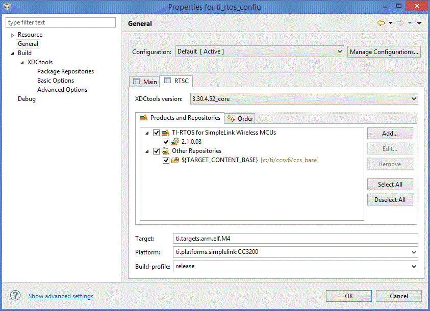

I'm trying to run through Project0 for my CC3200 Launchpad kit, and I have the following errors while trying to build ti_rtos_config:

I've uninstalled, cleaned *everything* TI off of my computer, and reinstalled to find the same error.  the "simplelink" program builds just fine.
This is on Windows 8.1 x64.  What's odd is that I can build the project fine at home on my Windows 7 x64 computer, but I can't really use that for all of my development at work.  Can anyone verify that they can build in Windows8 or 8.1? Or am I just banging my head against an incompatibility?
Versions:
CCS: 6.0.1.00040
CC3200 SDK : 1.0.0.4
TI_RTOS for SimpleLink: 2.1.0.03
XDC Tools: 3.30.1.52_core, 3.30.03.47_core
TI Compiler: Same failure for 5.1.6 and 5.1.8
Windows: 8.1 x64
