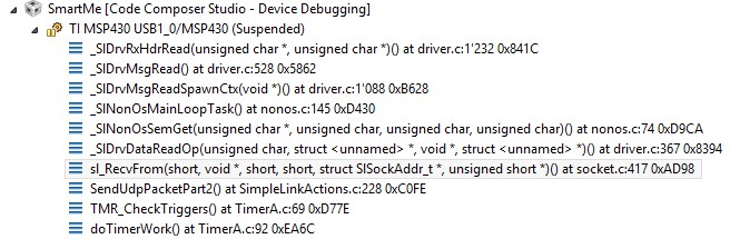

I'm using the CC3100 in non-blocking mode. Rarely the simplelink driver hangs in the sl_RecvFrom Method. It's quite hard to reproduce. My devices hangs about once all 4h. (Hangs once per ~2880 calls).
I think the problem is that the UDP Packet was not received correctly. This is not a problem, but the device should not hang forever in the sl_RecvFrom Method.
Call stack:
In the   _SlDrvRxHdrRead(_u8 *pBuf, _u8 *pAlignSize) Method the driver getting stuck at this line:

  • David,
    The protocol (for host <--> device communication) uses 32b synchronization words to keep the host and device in sync - In your case, it seems that the host has either missed or not able to identify this sync-pattern from the device, and hence a protocol error.
    Which host-platform are you using w/ CC3100? Were you are to reproduce the issue w/ 'Simplelink-Studio?
