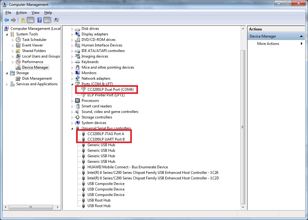

Hi Team,
I have an issue that I haven't found a resolution to on the forum here.
I am using a CC3200-LAUNCHXL board rev 3.2 with IAR Workbench 7.2.  I am trying to load an example program on to the Launchpad, but IAR can't connect to the Launchpad!
UniFlash has no problems, I have formatted the Launchpad and updated to the most recent service pack 1.0.0.1.0
The error happens on IAR when I try to start the debugger. The error says
"Fatal error: **ERROR**: Unable to connect - Check hardware, speed and interface selected.
Session aborted!"
I followed the steps listed in the quick start guide to the letter including replacing the driver library for lmftdi.

  • Hi Rob,
    Starting debugger session: Loading debug file - This is not appearing in failure case indicates that debug DLL might not be correct.
    Can you please confirm that below steps are taken care
    copy "armLMIFTDI.dll" to "C:\Program Files (x86)\IAR Systems\Embedded Workbench 7.x.x\arm\bin"
  • Also,
    Can you please check whether device manager shows JTAG in USB controller as shown in below picture.
  • Hi Kaushal,
    Here is a screenshot of the device manager.
    The device connects to UniFlash as well.  Debugging doesn't work in IAR however.

  • Hi Team,
    We have resolved the issue with the original PC.  With help from Victor, we determined it was a device conflict that the driver isn't capable of resolving.
    Another FTDI device was connected to the PC at the same time as the CC3200 Launchpad, and the driver is unable to distinguish between the two different devices.
    Disconnecting ALL other FTDI devices from the PC solved the problem.
