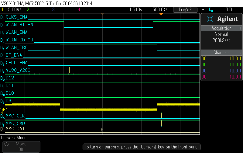

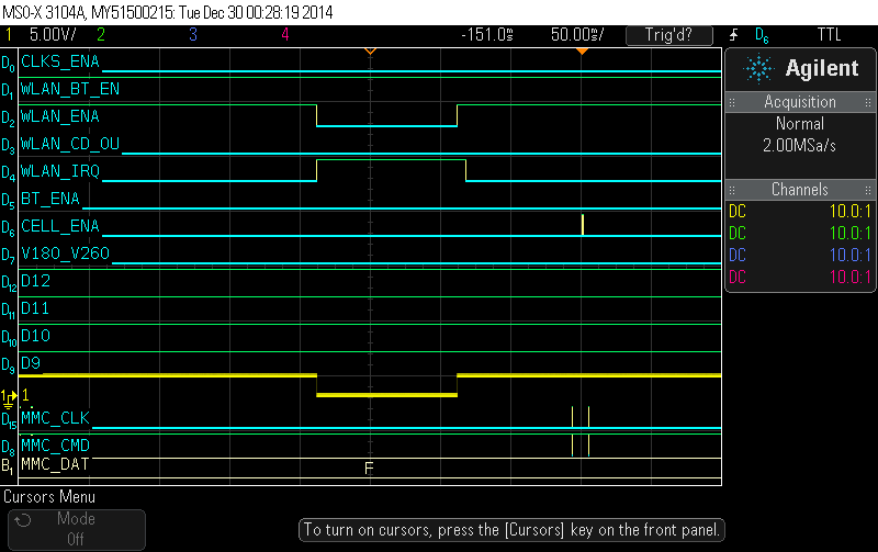

  • Joseph,
    I'm just now getting back to this problem; I had to attend to some higher priority issues.
    I couldn't use your scripts as is because they are for an Android system, but I tried the same sequence of commands. It didn't help.
    This is what I think is going on here: The wlan interface is able to boot up and manage to get associated with an AP and then transfer data without any apparent problems. The problem comes if the firmware must be booted up a second time. This occurs if the interface is taken down (e.g. ip link set dev wlan0 down) or restarted, and it even occurs if the firmware must be reloaded due to a role shift (e.g switch from station role to AP role, or from single role to multi-role).
    See the dmesg logs (dmesg_wlan0_debug and dmesg_wlan0_down_up) in the attached zipfile. In both cases all debug tracing in the driver is turned on. The dmesg_wlan0_debug log shows the sequence when the driver is booted up the first time; everything works. The dmesg_wlan0_down_up log shows the sequence that occurs when first the 'ip link set wlan0 down' command is issued (at time 597.366796). Then the 'ip link set wlan0 up' command is issued (at time 681.529384). In both up and down cases, the driver fails to (re)boot the firmware; it fails with "timeout waiting for the hardware to complete initialization".
    It seems like the firmware is getting loaded properly, and it seems to boot, but apparently it fails to signal initialization complete. Or maybe the firmware is signalling properly, but the driver is in a state in which it fails to get the completion interrupt. I checked the value of the interrupt vector bits that are returned by the firmware, and they have a value of 0x1, which is a hardware watchdog timeout. Maybe the watchdog interrupt is preventing the initialization complete interrupt from registering(?).
    I'm convinced that this is the reason that the multirole operation is not working, because the firmware must be reloaded in order to support that mode, and the reload fails. In the case of AP mode, I was able to get that to work if I prevent the device from booting up in station mode first.
    Are you aware of any problem with the driver similar to this that has been solved, or from the evidence in the logs (e.g. something missing, out of sequence, etc.) can you maybe determine what might be going wrong here?
    Thanks for any clues you can provide.
    --ken

    [   21.168328] net eth0: phy 4a101000.mdio:01 not found on slave 1
    I tried several variations on this sequence and also tried different delay values in steps (6) and (7) of the sequence.
    I verified that the WLAN_ENA signal is in fact being controlled as described above at the WL1271 WLAN_ENA pin.  I have attached a scope image showing the failure scenario (see attached file wlan_ena.png).
    In the scope trace you can see the various signals at the WL1271 device (on the 3.2 V side of the level shifters).  The yellow trace is the WLAN_ENA signal at the pin of the WL1271 device.  The blip on signal CELL_ENA at 80% (400 ms) into the trace is a debug signal that I inserted at the point of failure.  This coincides with the "wl12xx_debug()" message in the log above.  You can see that the WLAN_ENA signal was de-asserted for 100 ms and then re-asserted about 150 ms prior to that point.
    I am completely baffled by this behavior, and I cannot understand why the device is behaving this way.  Please let me know if you can suggest any other things to try.  I have a demo of the system scheduled for one week from now, and I really need to get this issue resolved.
    Thanks!
    --ken
  • Joseph,
    I forgot to mention, another thing I tried is turning off the power to the WL1271 device in the reset() function, and re-enabling the power in the init() function.
    That doesn't work either. This makes me believe that maybe there is something else going on here, like maybe some issue with the mmc driver.
    I've attached a scope trace showing this scenario below.
    The WLAN_BT_ENA signal is the enable for the 3.2 V / 1.8 V level shifters (high = enabled). The V180_V260 signal is the enable for the 1.8 V and 2.6 V regulators (low = enabled), the 1.8 V regulator supplies power to the WL1271 device.
    --ken
  • Joseph,
    I was able to resolve this problem by moving the calls to the reset()/init() functions from where they were in the WL1271 driver such that the chip is reset (WLAN_ENA de-asserted then asserted) prior to the power management calls (pm_runtime_get_sync(), mmc_power_restore_host(), pm_runtime_put_sync()).
    The driver is now able to re-initialize the WL1271 device.
    --ken
