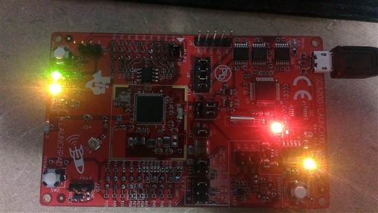

Info: D5 and D6 (green and orange) LEDs are on.  The orange LED D1 is on, it turns off when the reset button is pressed, and finally the red D4 power LED is on.

    The green LED D2 is on as well.

    I have the launchpad configured in the same way as my original post, except now the green LED D2 is on, unsure why.

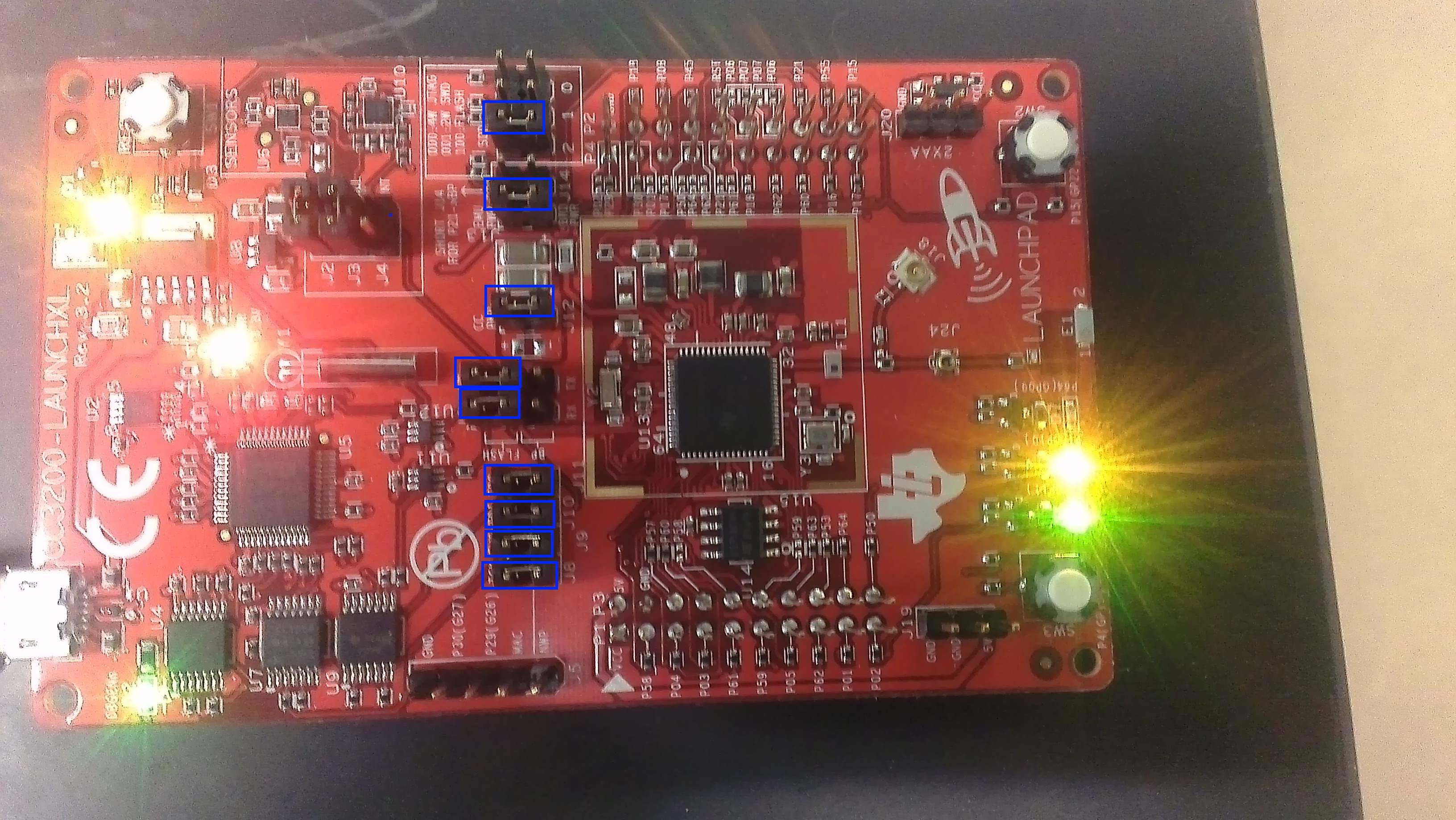

  • When using IAR and CSS I am using the launchpad with the configuration below:
    I put blue squares around the connected pins to make it easier to see.  Both SOP2 and J8 are connected.
  • and are you able to debug and work with the device this way? Is it only Uniflash that is not working?
  • I get the JTAG error in IAR with this configuration and an "unable to connect to device" error with CSS.
  • So in this case, most likely your device got defected somehow.
