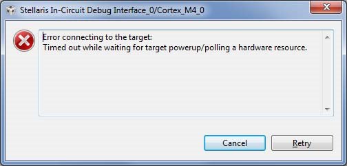

I can't connect to CC3200 at last step of debugging with CCS6. Message is: Error connecting to the target
Launchpad is recognized (COM ports are OK).
No other applications use these ports.
SOP jumper is in place. Jumpers J7 and J8 are in flash position.
But I can't connect to the launchpad when I launch the debugger on CCS6. Same with energia:: can't open device, read ack failed, failed to trigger bootloader.
I could once load with CCS when I loaded wlanstation example and ran it successfully. I also used Energia and temboo and successfully ran the email example.
I put jumper 8  in place again.  I have changed USB cables.

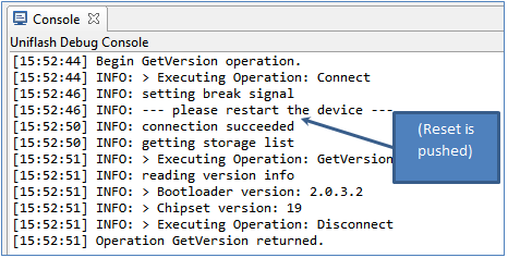

  • It didn't solve the problem. I still can't connect to CC3200 with Uniflash:
    Uniflash debug console:
    [19:27:07] INFO: setting break signal
    [19:27:07] INFO: --- please restart the device ---
    [19:27:22] ERROR: ---reading ACK signal failed---
    [19:27:25] INFO: setting break signal
    [19:27:25] INFO: --- please restart the device ---
    [19:27:40] ERROR: ---reading ACK signal failed---
    [19:27:40] FATAL: --- Can't connect to device !! ---
    [19:27:43] FATAL: Error connecting to the device. Please check your COM port settings. Error code: -3
    [19:27:43] INFO: > Executing Operation: Disconnect
    [19:27:43] Operation GetVersion returned.
    What could be the problem with the COMP port settings ? Below printscreen of the settings:

    When you execute the Get Version option in UniFlash and get the "INFO: --- please restart the device ---" prompt on the Uniflash Debug Console, are you pressing the reset button on the CC3200?  If you don't press reset when prompted by UniFlash, you'll get the following sequence of output in the Uniflash Debug Console:
