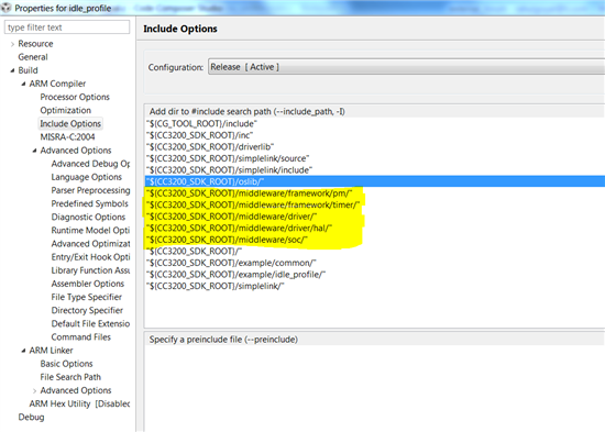

  • Hi Fernando,
    Are you linking the middleware library to your application?
    Rahul
  • Hi Rahul,
    I followed your suggestion. My current configuration is as follows.
    * Compiler include options:
    * Linker, file search path:
    But when I include the line "cc_app_putoff_pm();", I got the error:

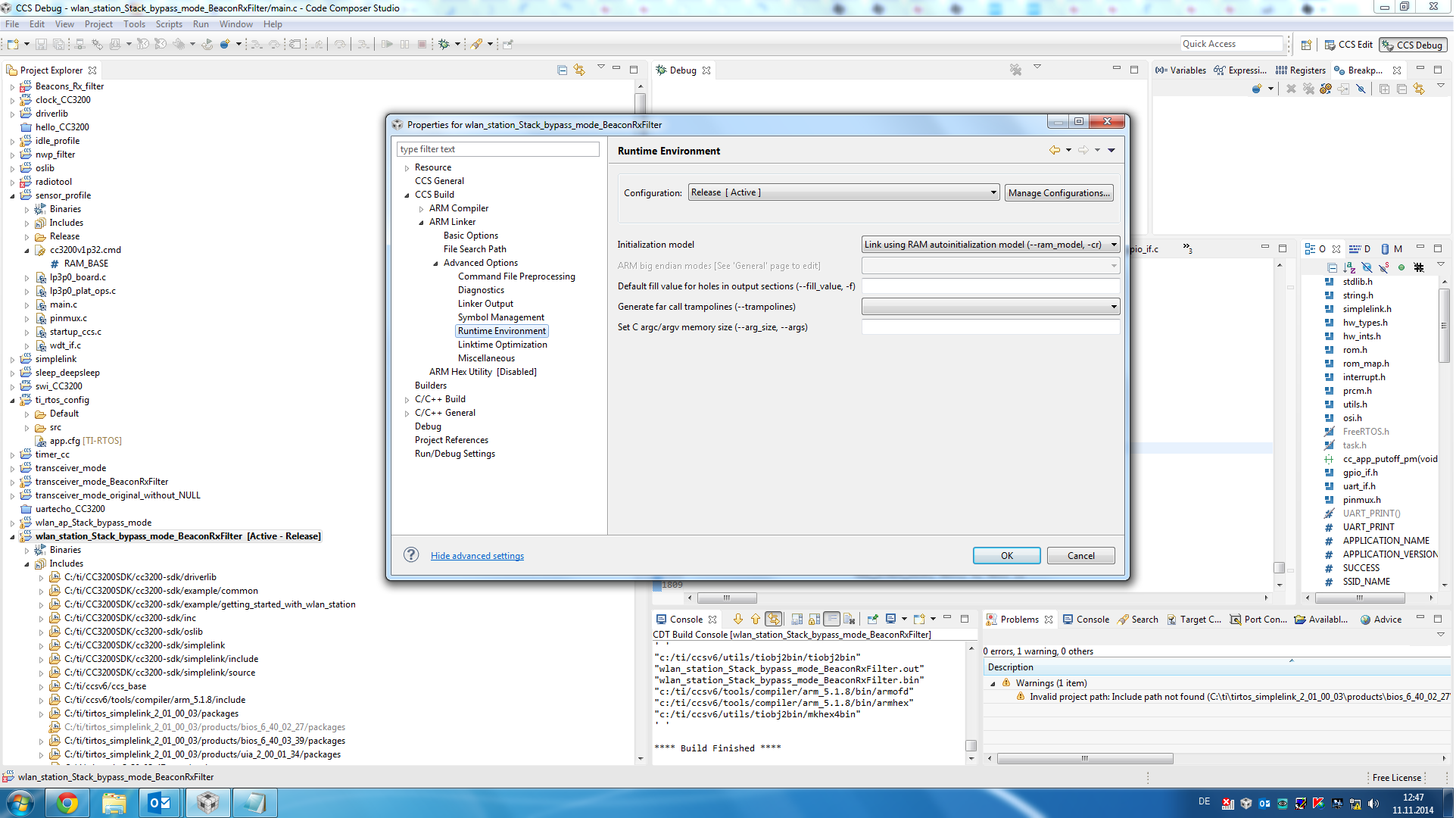

    <a href="file:/c:/ti/ccsv6/tools/compiler/dmed/HTML/10099.html">#10099-D</a> program will not fit into available memory. placement with alignment fails for section ".cinit" size 0x2f1 . Available memory ranges: cc3200v1p32.cmd /wlan_station_Stack_bypass_mode_BeaconRxFilter line 75 C/C++ Problem
    However, the error was gone setting optimization options and:
    Thanks!
  • Unfortunately, the application does not run as expected with the setting in the last figure. So, I set the "Initialization model" back to "Link using ROM autoinitialization model" in the last figure. So I am back with the errors:

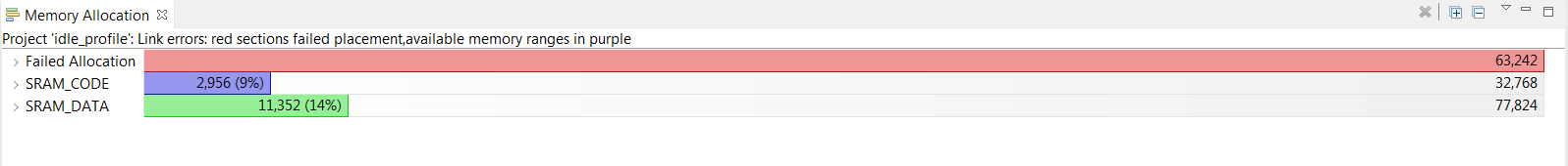

  • Hi Fernando,
    whenever you link a library to an application, all library function used by application will take up the required memory.
    The SRAM memory is allocated between SRAM_CODE and SRAM_DATA. The default allocation for both are:
    SRAM_CODE: 0x19000
    SRAM_DATA: 0x13000
    In your case, the memory required by code is more than the allocated memory. you can confirm this by checking the memory allocation under view menu.
    it will be something like this:
    As you can see the space allocated for the SRAM_DATA is not being utilised in this case. you can use that memory for SRAM_CODE. you can do this by modifying the cc3200v1p32.cmd file
