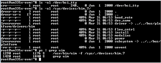

    From the software point below are the steps you need to follow for bringing up Bluetooth on Am335x+WL18xx:
    Please see http://processors.wiki.ti.com/index.php?title=WL18xx_AMxxx_platform_integration_guide
    Get the am335x-evm-sdk-src-07.00.00.00.tar.gz and am335x-evm-sdk-bin-07.00.00.00.tar.gz fromhttp://software-dl.ti.com/sitara_linux/esd/AM335xSDK/latest/index_FDS.html, link to this is provided in the previous link.
    extract the src and applied the patches and built with the Cross compiler (arm-linux-gnueabihf-), you can get the cross compiler from the above link or even if you install the "install.bin", you will have it at location "ti-sdk-am335x-evm-07.00.00.00/linux-devkit/sysroots/i686-arago-linux/usr/"
    and once the kernel is built you can copy the .dtb and ZImage to the boot partition. after extracting the bin folder,You will see the file system directly which you can copy to ROOTFS (file-system) partition. UIM is already part of this file-system.
    Install the Bluetopia SDK on your PC, and just copy the executables from "BluetopiaPM/bin" of your PC to "/home/root/ss1" of the file-system.

    You can not build the Bluetopia Core library's. as the Core stack is provide as library's (without the source). So I am not sure if the default library's will works with opemwrt. I have not tried it myself.
    See the demo page on how to run the Bluetopia executable on Linux  http://processors.wiki.ti.com/index.php/WL18xx_Bluetopia_Platform_Manager_Demo_Guide
    See how the turn on looks like

    now i can see hci0 but it show "Bluetooth: st_register failed -22", i got new log in my last port.
    I hope the UIM is running?
    looks like your GPIO is not toggled correctly.
    Also probe the UART lines(Rx, Tx, RTS and CTS ) to make sure that the UART configuration is correct.
    Also check if you have done the software configuration correctly in the DTS file with respect to the UART you are using.
    Could you provide the kernel and user space logs.
    Do we need to run UIM with bluetooth module?

    Please check the below
    “ls –al /sys/device/kim.x/”
    “ls –al /dev/hci_tty”
    “ps | grep uim”

    UIM is required for the Bluetooth to work. Please ensure that  you have uim-sysfs (attached) file in /etc/init.d/. http://e2e.ti.com/cfs-file.ashx/__key/communityserver-discussions-components-files/307/3247.uim_2D00_sysfs
