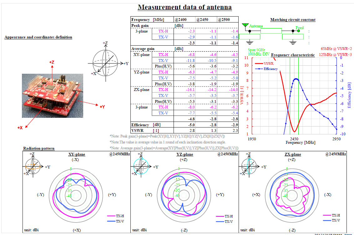

Please let me know which are the characteristics of the build in antenna in the CC3200 board. In particular I am interested in the antenna gain. Thanks!
The attached pattern is measure on the CC3100 board, but the performance is similar on the CC3200 board as we use the same antenna
