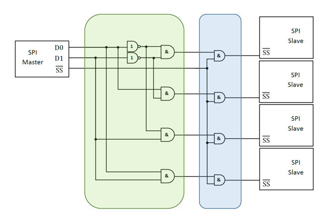

I want to connect one of the two (or both) 433 MHz RF receiver modules to the CC3200 LaunchPad:
I'm a hardware newbie, so I don't know how to connect them and how to address them in CCS.
Can someone please enlighten me on how to connect these with the LaunchPad pins?
I also want to connect an SD Card connector to the LaunchPad at the same time. Is this possible? Is it possible to connect all three devices to the CC3200 LaunchPad at the same time and get each of these addressed?
I guess it would require two additional chips, one to change binary format to dedicated lines (green below) and one 4-way AND gate (blue below):
Is this assumption correct? Or is there already something similar available on the LaunchPad?
Which chips would I require to accomplish the green and blue area?
Your help is appreciated.
        If you have extra GPIO's at your CC3200 Launchpad, you can set those as Slave Select. That way you won't need the additional chips.
        See, tutorials of SPI interface in the internet for more info.
    - kel
  • Thank you for your reply.
    OK, I understand: Using any of the GPIO pins I can select each of the SPI devices on their own.
    Will it be necessary to apply pull-up or pull-down resistors for the SS pin? Or can I just connect the devices immediately?
    There is another non-trivial question bothering me regarding connecting these RF receivers to the LaunchPad:
    The data coming in from the receivers - there is no clock pin or anything else. How will I connect their data pin to the LaunchPad and receive data reliably?
  • Hi
    Regarding the 433MHz module, the data pin has to be connected to one of the UART pins available on the CC3200. This pin can be found from the datasheet for the CC3200 or the pin-mux tool.
    But on the 433MHz transmitter side you would have to use a UART standard so that the CC3200 works correctly with this. You may need to use an inverter in case the default state of the Data Out line from the RF83C IC is LOW.
