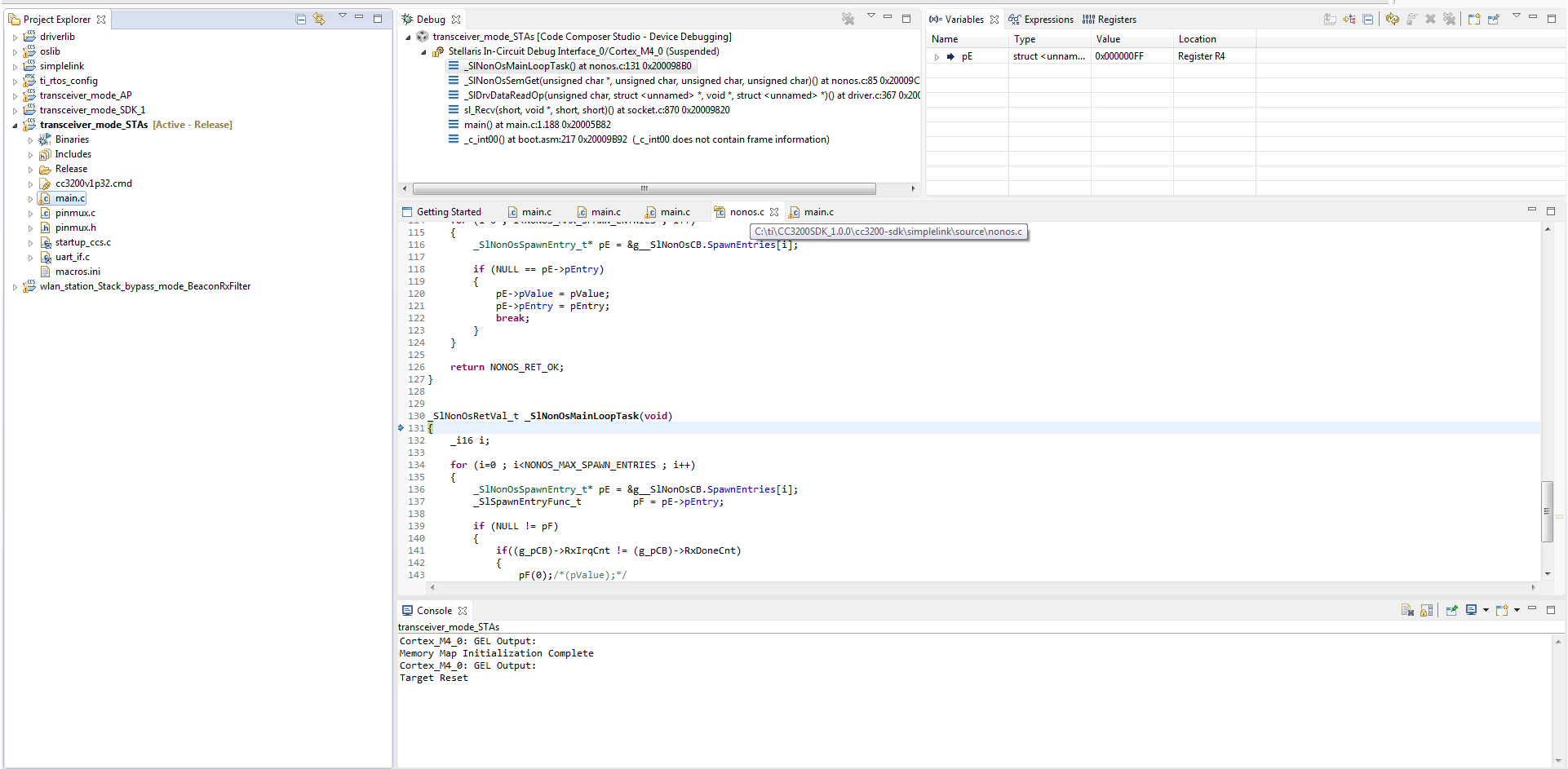

I am modifying the transceiver_mode example. I have 2 tasks with different priority. The task with priority 2 initializes the board and configures it, this task ends properly and there are no loops in it. The task with priority 1 has an infinite loop where I:
* Read frames in the transceiver mode
* if (memcmp(&(buffer[8]),RawData_Ping,122)==0)
       - A frame is sent in the transceiver mode
The program runs as expected, but after an arbitrary amount of time it stops, without any error or message either in the console or the UART. It seems that there are no problems with memory neither. When I pause the code, it directs me to different parts in the file "nonos.c".
What could be causing this behavior? a power management policy? I need the system to be working indefinitely, until I manually reset it. Thanks!
  • Hi Fernando,
    If you are using RTOS with simplelink drive then nonos.c shouldn't be used at all. Can you check and make sure that you are using the library compiled for OS environment. For CCS it should be available under <cc3200-sdk>/simplelink/ccs/OS  directory.
    Ankur

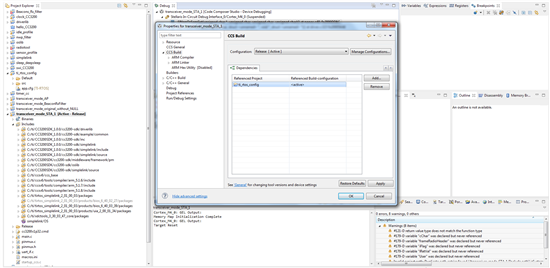

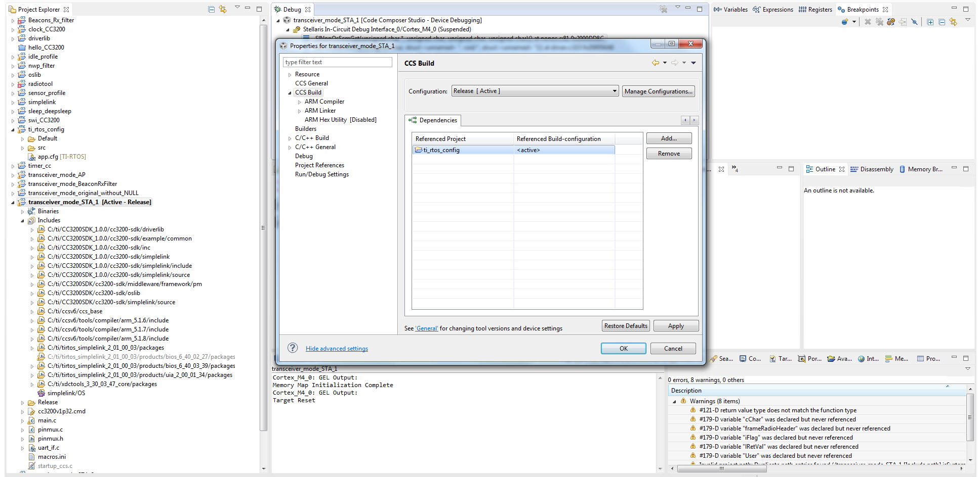

  • Hi Ankur,
    I included the simplelink.a, that is under <cc3200-sdk>/simplelink/ccs/OS  directory. Is this what you mean? Note below that <cc3200-sdk>/simplelink/ccs/NON_OS/simplelink.a is also included, if I delete it I get errors regarding _SlNonOsMainLoopTask. In the code I have twice:
    #ifndef SL_PLATFORM_MULTI_THREADED
    _SlNonOsMainLoopTask();
    #endif
    This is part of the Transceiver_mode example, so I don´t modify that. But leave <cc3200-sdk>/simplelink/ccs/NON_OS/simplelink.a included.

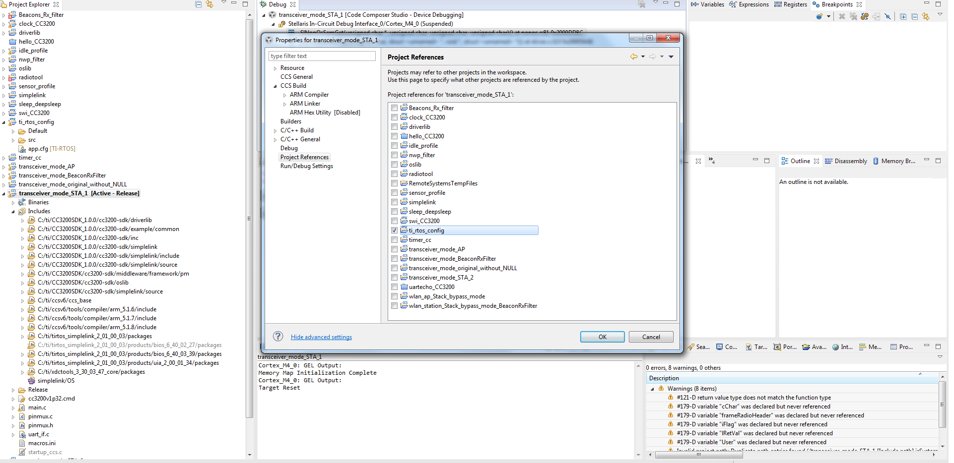

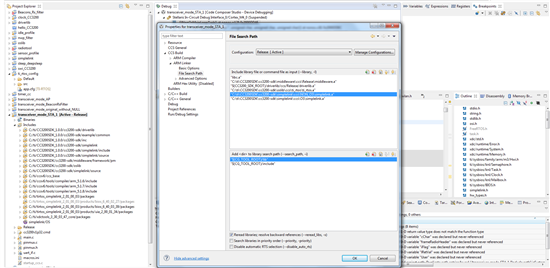

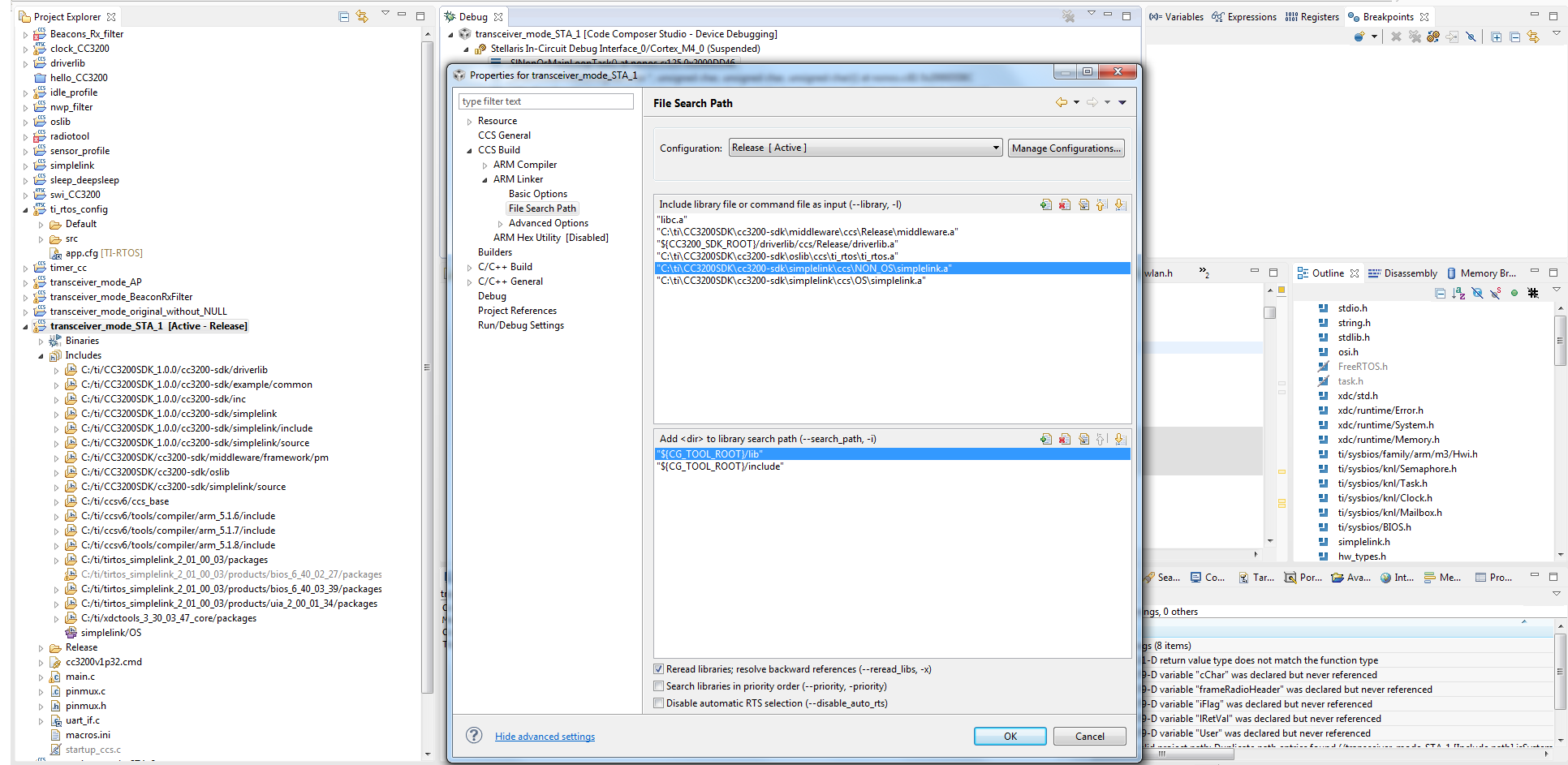

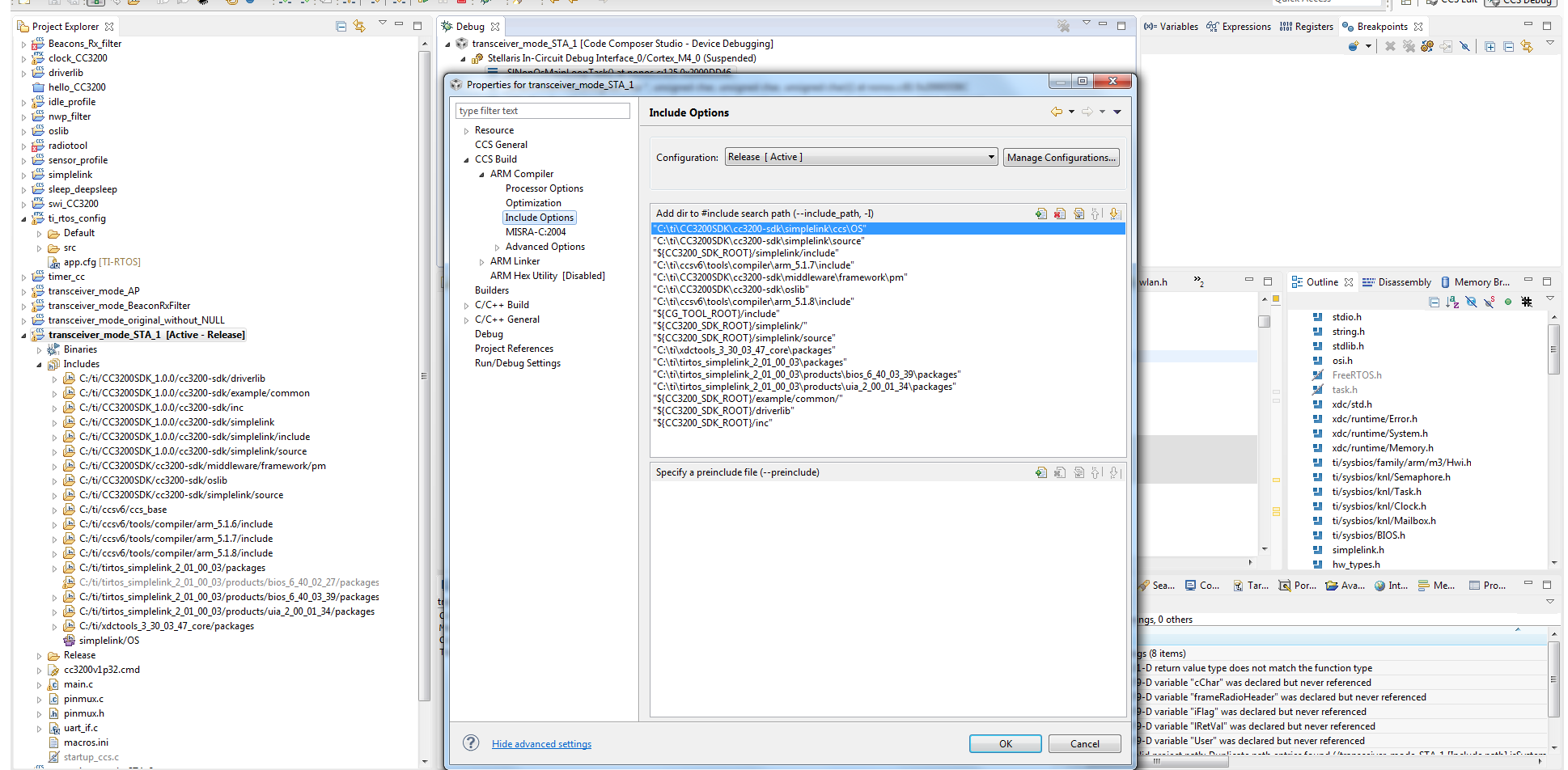

    Maybe I have a mix of OS and NON_OS configuration. The current configuration is as follows:
    //USE_TIRTOS;
    //USE_FREERTOS;
    Compiler include options
    Linker File Search Path
    CCS Build Dependencies
    Note that ti_rtos_config is a project reference

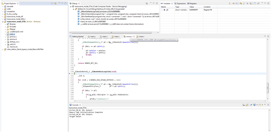

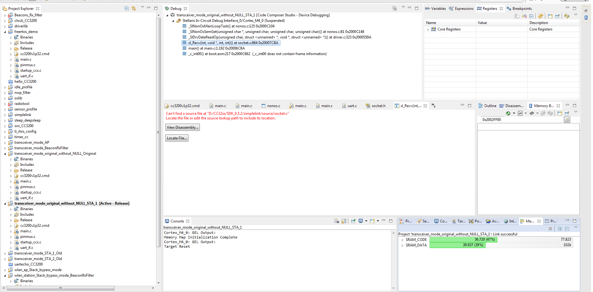

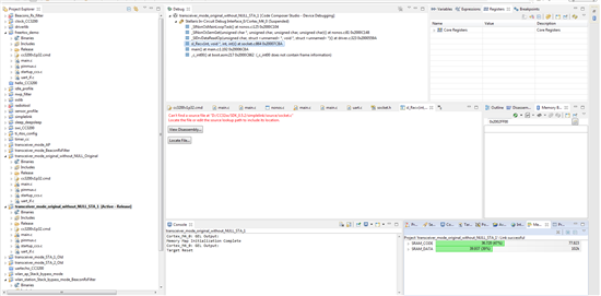

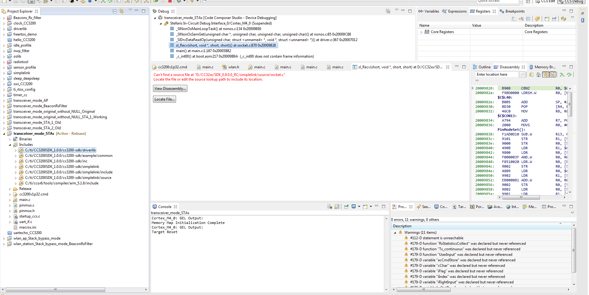

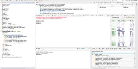

    Still, the program seems to run properly initially, but suddenly the proper behavior stops. If I pause the debugging session, I just get:
    Can't find a source file at "D:/CC32xx/SDK_0.5.2/simplelink/source/nonos.c"
    Locate the file or edit the source lookup path to include its location.
    I am not sure if I have the proper operating system configuration.

  • Hi Fernando,
    You shouldn't use Non-OS and OS libraries simultaneously.
    I suggest you to check the SDK example using the RTOS as a reference. You can also use exiting RTOS example as base and start modifying it for your application.
    When using the OS environment, SL_PLATFORM_MULTI_THREADED should be defined in project properties. Since you are using TI-RTOS you should also define USE_TIRTOS in project property.
    Ankur

    The program compiles without errors, and runs as expected, but suddenly, the proper operation stops (you can recognize this event because the output at Teraterm stops) and if I pause the debugging session I just see the message:
    Why? What can I do?
    Please let me know how to solve this issue. I need the program to be running indefinitely.
    Thanks!

    After reading your comment, I took the transceiver_mode example from SDK 1.0.0 and modified it. Just the main.c file was modified. The resulting main.c file is attached.
    6470.main.c
    But the result is the same. The program runs as expected and suddenly stops. When I pause it, I am directed to a function I have not modified.
    I uninstalled the SDK and installed it again. I installed:
    CC31xx_CC32xx_ServicePack-1.0.0.1.2-windows-installer.exe
    CC3200_OTA_Update-1.0.0-windows-installer.exe
    CC3200SDK-1.0.0-windows-installer.exe
    In that order.
    The result was the same, although I have the impression that now it takes longer until the proper operation stops.
    In one of the trials I found the result in the following figure when I pressed "Pause":
    That is, the program was looking for the file socket.c in the driver D:\
    I do not have TI programs in D:\
    so I searched for the socket.c file in C:\ and chose the proper path.
    Thanks for your help in advance!
