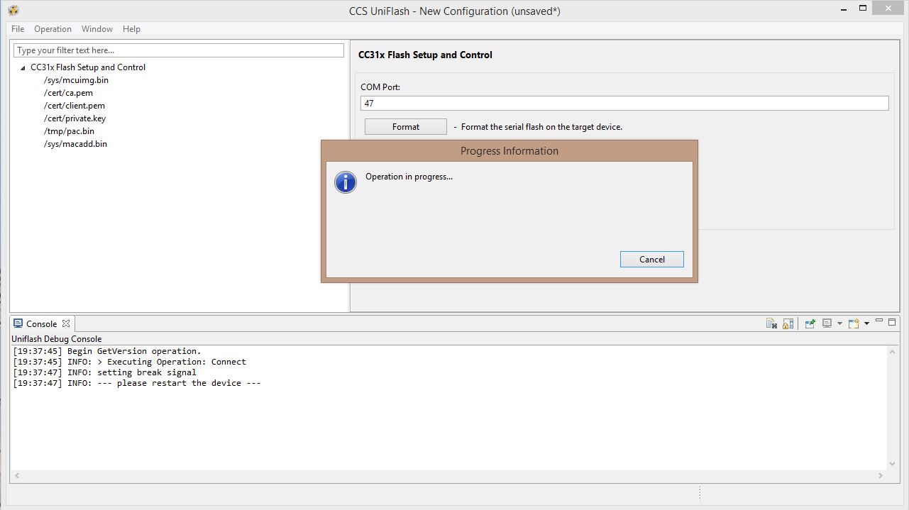

I'm trying to flash the CC3100 Service pack using Uniflash 3.2.00065 and the CC31XXEMUBOOST.
When I plug the combination of the Emulation board and booster pack into my laptop, I have 4 COM ports: 45-48.
According to the Uniflash documentation, this is the case of 'non flashed FTDI' and I should use the 3rd COM port for flashing (COM47). When I simply do a 'Get Version' operation before trying to format the target, the Uniflash console indicated that it made the connection, then telling me to restart the device. Since there are no 'reset' button on the emulator board or the booster pack, I removed the power from the devices instead.
Problem is that Uniflash never sense the device coming back up. Below is the console message:
Can someone help.
