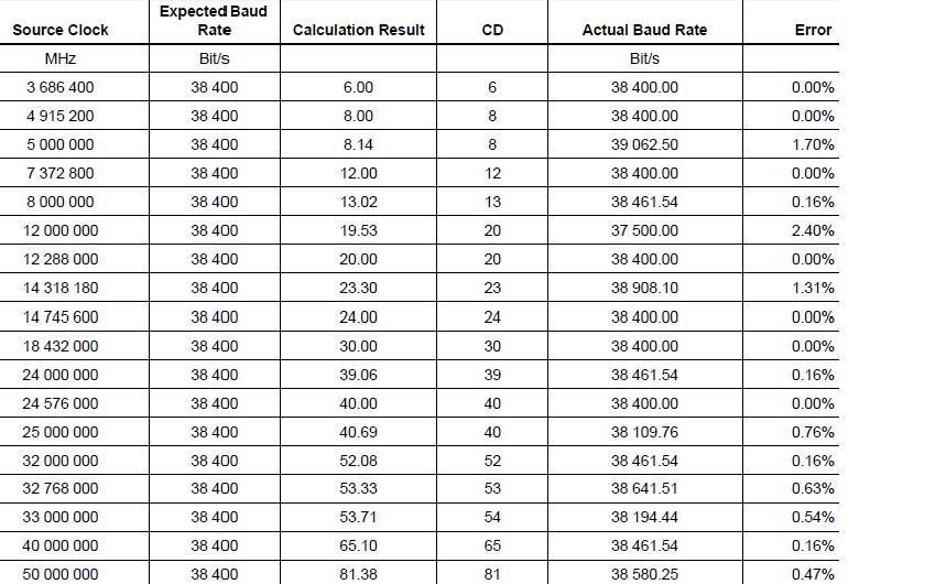

I want to get the error rate report of baud rate of CC3100/CC3200 in different system clock.
Please tell me how to get it. Thank you very much.
For example:
