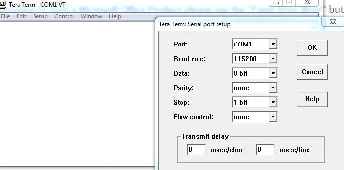

I am trying to see UART demo on CC3200 launchpad.
I have connected the CC3200 board to the PC with CCS6.0 via the USB connection.
I have enabled the Serial port connection on my PC as mentioned in the example doc.
When i run the UART demo, i dont see any prompt getting on my serial terminal.
I see the following error on the CCS console
Cortex_M4_0: GEL Output:
Memory Map Initialization Complete
Target Reset
Cortex_M4_0: Trouble Reading Memory Block at 0x20030054 on Page 0 of Length 0x1: Debug Port error occurred.
Cortex_M4_0: Trouble Reading Memory Block at 0x20030058 on Page 0 of Length 0x4: Debug Port error occurred. "
I dont know whats getting missed out. BTW i was able to run the other demos like blinky and httpserver.
Sreenivasa
  • Guys,
    I figured out the reason.
    The CC3200 was connected to com port 9. The Tera term was showing only comport 1- 4 , so i had opened the tera term on com port 1.
    Solution: I forced the com port of the CC3200 to com port 2 and then established connection to com port 2 on tera term also. Things worked fine.
