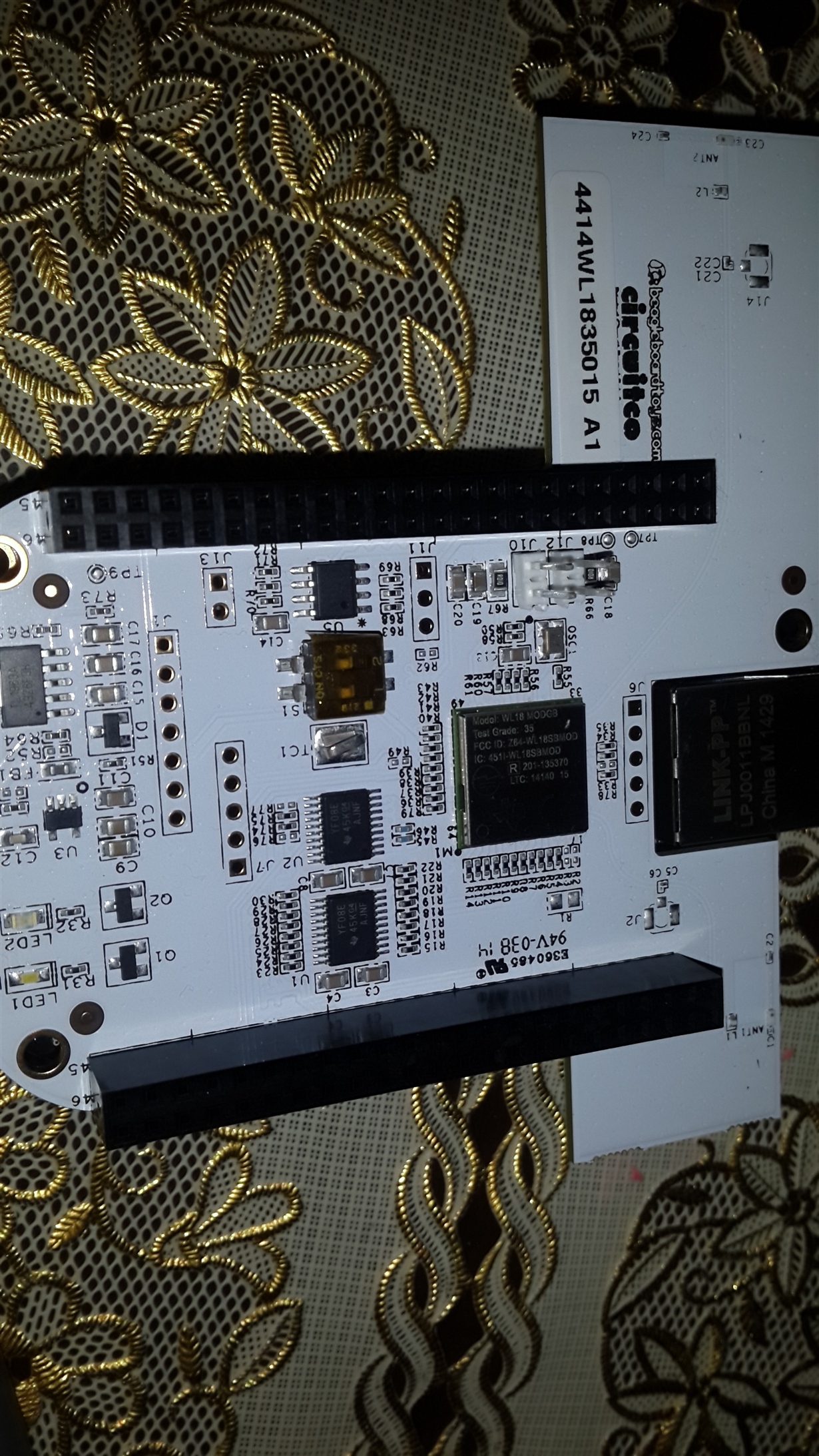

    2. For BBB it is a bit tricky as unlike the BBW, the serial port doesn’t have a connector and you need to use a USB level shifter.
    See attached picture. The connector is located below the WL8 cape.

     2. I am using the Cape from circuitco. I can see four J pins on the top of it. Please let me know if I can use those pins.
