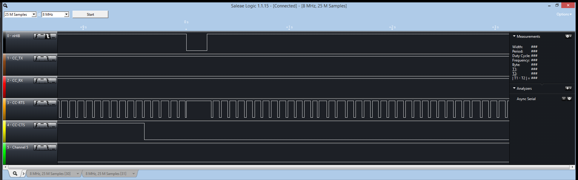

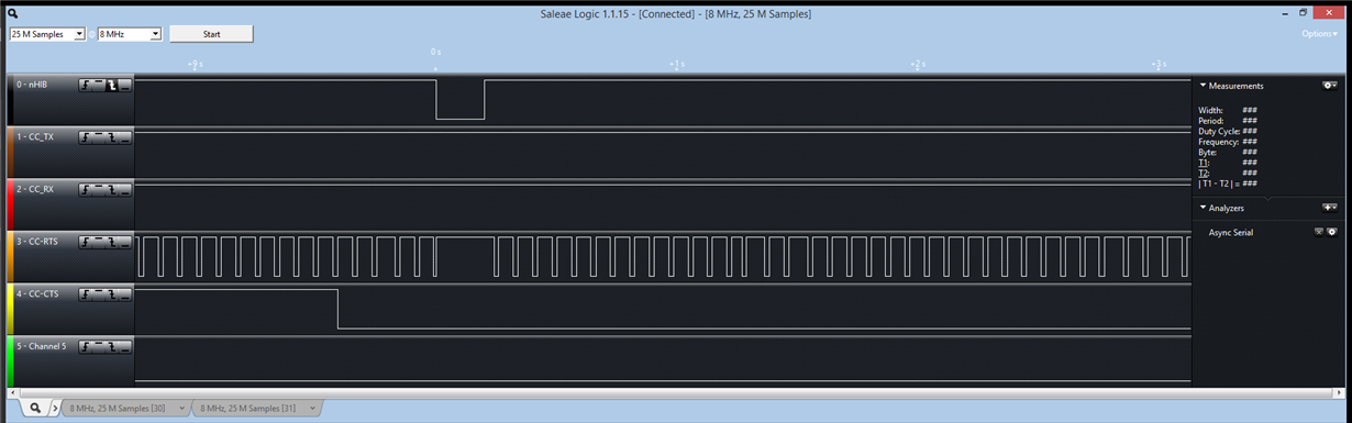

  • I don't know why the RTS line behaving like this, I've checked with continuity test between RTS and XTAL pin, nothing, since they are next to each other and RTS line being pulsed with frequency of 12.4 KHz
    Actually it was pulsing with 32khz, but after removing the pull down resistor from RTS line, same as boostpack ver 3.3, the pulsing changed to 12.4khz!!
    hope this help you in guiding me to source of the problem

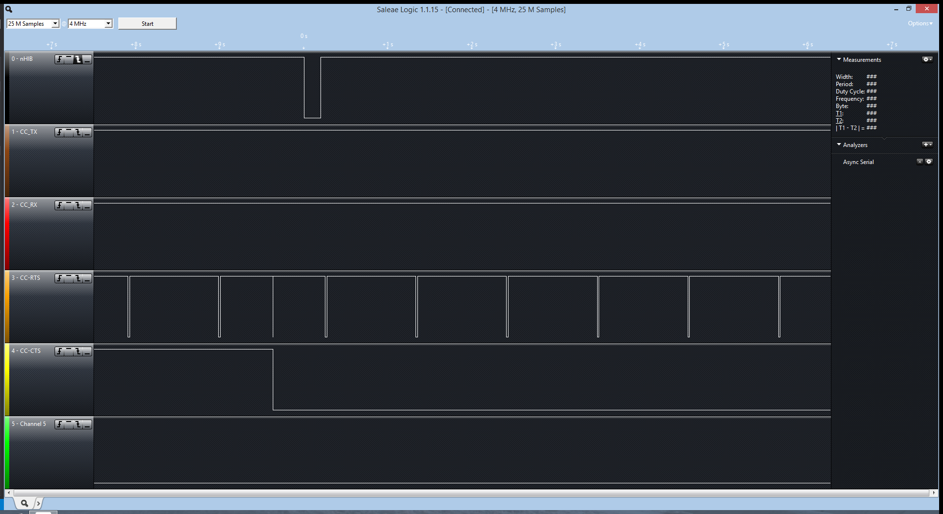

  • Here is a screen shot, of another custom board. again, I can get version, format, update service pack
  • Can you probe on the power supply line of your board to see if it is stable throug-out. During the SL-start, the device would initiate a calibration cycle which can draw high currents upto 500mA. Please ensure that your board is able to source that current.
  • The voltage regulator rated for 1A 3.3v
    There are additional two 100uf ceramic capacitors next to CC33100
    just to make it more clear, the first picture was by using 32khz OSC
    The second running by this crystal:
    ABS07-32.768KHz-1-T
    its almost same as the one being used in Ref. Design, except this one has 10ppm compared to 20 in the Ref design
