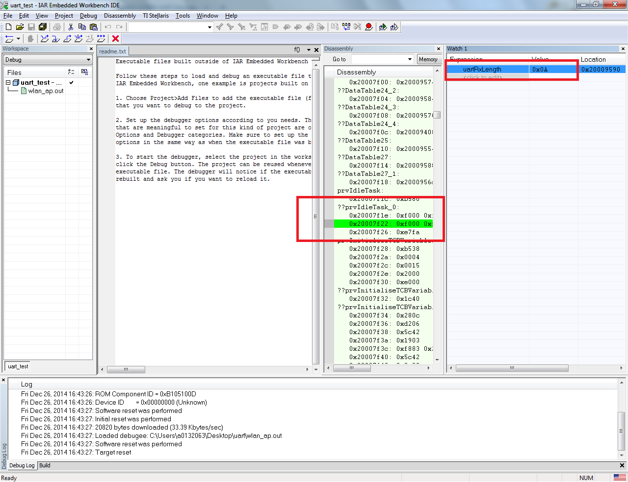

James,
With your code I could easily receive 200 characters without any issue into uartRxBuff.
One next key press it goes to FaultISR. Can you please confirm if this condition is not hitting in your setup.
Simply change this uartRxBuff[uartRxLength] to uartRxBuff[uartRxLength%MAX_RX_BUFF] in the interrupt handler.
Praveen
James,
Apologies for that, I missed the IAR version you mentioned, we had a known issue with IAR 7.20 for which the patch was released.
I tried your code on IAR 7.30.4 (a fresh installation), CC3200SDK_1.0.0, CC3200-LAUNCHHXL REV 4.1 but still I am not able to recreate your issue.
From your shared code you are using UARTA0 only for Displaying banner, there is only one task 'ZigbeeUartParse' which keeps printing something on UARTA1 and the interrupt handler is responsible for receiving on UARTA1. Is my understanding correct?
I am only feed characters to UARTA1 interface.
See the image below, I used the wlan_ap.out file you had shared instead of compiling it on my setup. I could receive 10 characters without any issue, the code is still looping in prvIdleTask not in FaultISR.
Thanks and Regards,
Praveen
