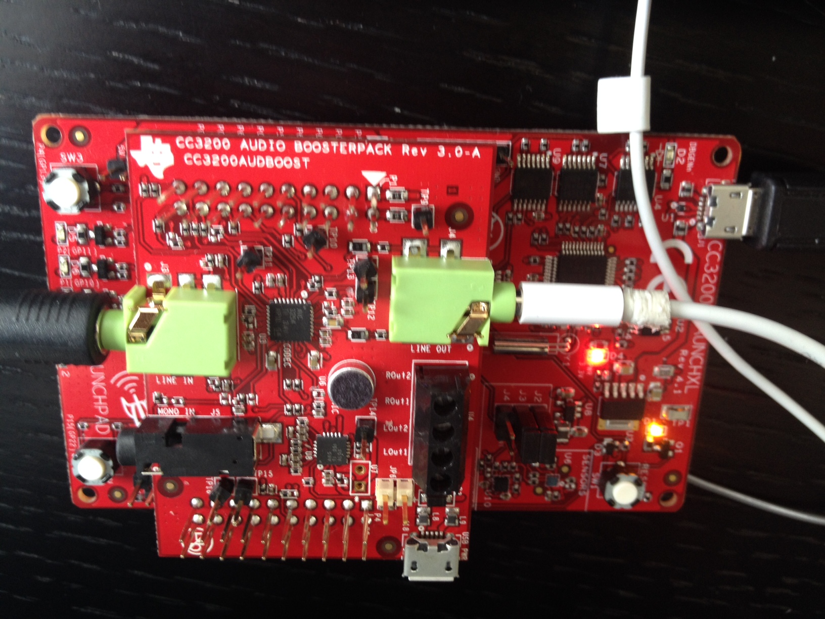

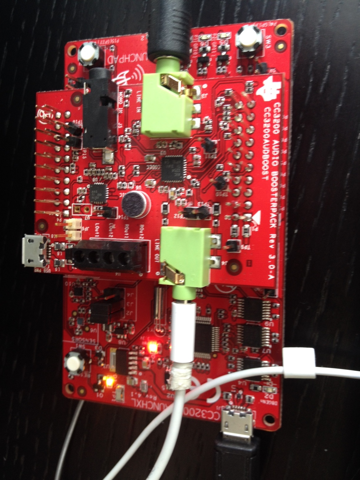

  • Hi Aashish
    I have followed the three steps you mentioned before for the loopback application. As I only one LP and one audio boostpack. I want to record the voice using onboard microphone and play it using LINE_OUT.
    1. I changed the NETWORK value from 1 to 0 in network.h file.
    2. I use double slash to comment the speaker and network task in the main.c.
    3. I change the value of g_ucMicStartflag from 0 to 1 in the control.c.
    Then I compile it using Code composer studio and generate new bin file which is then used to flash into my CC3200 LP.
    When I remove the jumper on SOP2 and reset the LP. The green and yellow light D5 and D6 is still on.
    May I know the possible reason causing this?
    Heng
  • Hi Heng,
    J2 and J3 drive these led by default. As you disable network part, they are still on, Is it application not working in loopback mode?
    Aashish
  • Dear Aashish
    I have solved the problem as I did not flash correctly. A new problem occurs as when I connect the LINE IN to the music, and the LINE OUT connect to headphone. I first press the SW3, the green light is always on indicating it is streaming. Then I press the SW2, however, the orange and red light does not come out.
    May I know if the procedure is correct for loop back application?
    Heng
  • Hi Heng,
    You dont need to press SW2/3 as you are setting g_ucMicStartflag value to 1. As soon as application come up it will start recording audio from LINE_IN and playing back to LINE_OUT.
    Aashish
