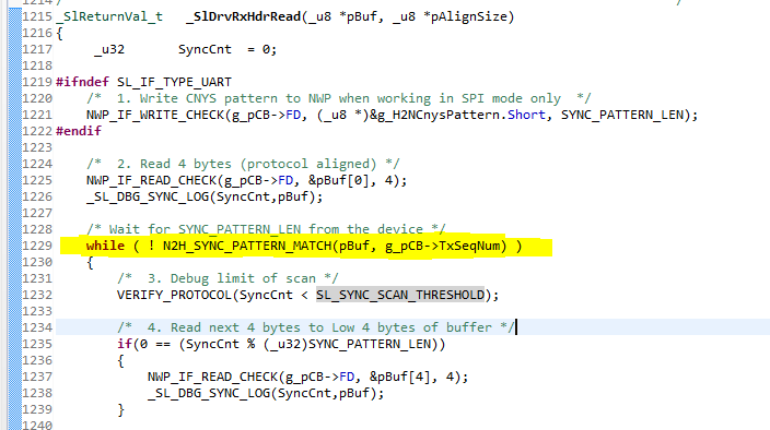

When I'm trying to communicate with CC3100MOD using MSP430F5529LP, the program gets stuck at
The same project works absolutely fine with CC3100BOOST.

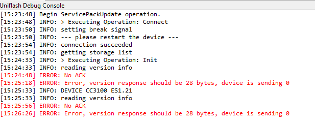

For 'Service Pack Update' option, Uniflash stops responding after following messages.

  • When I try 'Service Pack Update' on another custom board,
    I get
    [16:27:19] Begin ServicePackUpdate operation.
    [16:27:20] INFO: > Executing Operation: Connect
    [16:27:22] INFO: setting break signal
    [16:27:22] INFO: --- please restart the device ---
    [16:27:26] INFO: connection succeeded
    [16:27:26] INFO: getting storage list
    [16:27:26] INFO: > Executing Operation: Init
    [16:27:26] INFO: reading version info
    [16:27:26] INFO: DEVICE CC3100 ES1.33
    [16:27:28] INFO: > Executing Operation: ServicePackUpdate
    [16:27:28] INFO: Path to the service pack file: D:\Tools\CC31xx_CC32xx_ServicePack_1.0.0.1.2\servicepack_1.0.0.1.2.bin
    [16:27:28] INFO: reading version info
    [16:27:28] INFO: ROM Device detected.
    [16:27:28] INFO: Service pack version information:
    [16:27:28] INFO: NWP version: 2.2.7.1
    [16:27:28] INFO: MAC version: 1.2.4.2
    [16:27:28] INFO: PHY version: 1.5.3.23
    [16:27:28] INFO: NWP Patch version: 2.2.0.1
    [16:27:28] INFO: MAC Patch version: 1.2.0.2
    [16:27:28] INFO: PHY Patch version: 1.0.3.23
    [16:27:28] INFO: Downloading file "/sys/servicepack.ucf" with size 6100
    [16:27:28] ERROR: Open operation failed
    [16:27:28] INFO: > Executing Operation: Disconnect
    [16:27:28] Operation ServicePackUpdate returned.
    You describe here 2 issues. One is getting stuck when reading the header via SPI interface. The second is not being able to communicate using Uniflash via UART lines (or at least partially). You also mentioned you are using CC3100MOD on a custom board. Can you describe this custom board in more details? it includes UART lines, SPI lines, host interrupt line. Also power lines are important.
