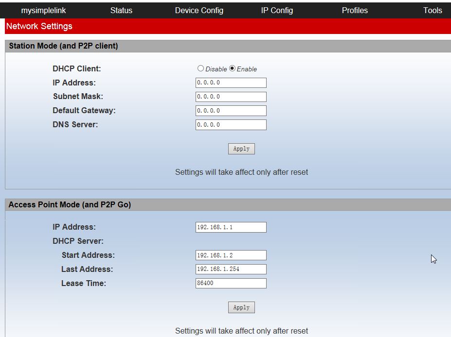

hi,
    I have used cc3200 .Now i want to set DHCP server address.The follow is my test in AP mode with HTTPSERVER project.
    First i format the 3200、service pack、program.Then i enter the setting page.
    1、I set Access Point Mode :
          IP 192.168.1.1;
          Dhcp server :start 192.168.1.252  . last 192.168.1.254
          I connect to the 3200,i get ip (192.168.1.252).this is right.
    2、I set Access Point Mode :
          IP 192.168.1.1;
          Dhcp server :start 192.168.2.252  . last 192.168.2.254
          I connect to the 3200,i get ip (192.168.1.252).this is not right.But i can enter the set page,and i can ping it(192.168.1.1).

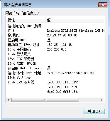

     3、I set Access Point Mode :
          IP 192.168.2.1;
          I connect to the 3200,i can not get ip ,this is not right.And i can not enter the set page,and i can not ping it(192.168.2.1).
     I have reset the device after set it.
     If i set  IP 192.168.2.1;  Dhcp server :start 192.168.2.252  . last 192.168.2.254   ,I get the ip is 169.254.131.46.
    I don't this is why,can you help me.
  • I can confirm that things behave strangely when you set outside the 192.168.1.X subnet, and that there are likely some issues. But I did get slightly different behaviour to you.
    IP 192.168.2.1;
    My iPad then connects with the IP address 192.168.1.5 and I can access the site on 192.168.1.1

    We have found it to be a bug. It isn't possible to configure the default GW from the HTTP server pages (which are using the system token). The only GW that is set is 192.168.1.xxx.
    The current workaround for this issue is to rewrite the setting webpage with a proprietary token for the default GW address.
    Setting the GW address from the host driver API works well.
    Alon
